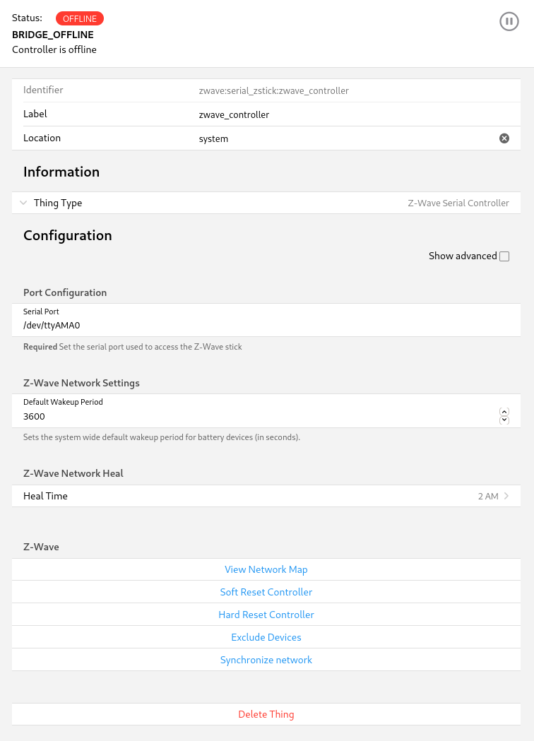

since i’ve been spending the whole day unsuccessfully getting the Razberry Board up and running on my Raspberry Pi 4 with Docker, I would like to ask for your advice.
I have installed the Z-Wave add-on, the device is displayed there under serial port, but the status is always offline.

What i noticed - sometimes i can select the controller in the GUI under serial port and then the next time i try it doesn’t appear again. Something shouldn’t be going very well there.
