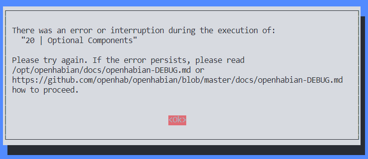

I am facing as it seems the same problem as described in post 1. The only difference is that I’m using a a fresh OpenHAB 3 install via openhabian on ubuntu.
Interestingly the path listed in the log viewer uses openhab2 despite a fresh install.
Reinstalling the log viewer results in an error. As described in post 3
So I did this:
But sudo systemctl deamon-reload gives me “Unknown operation deamon-reload”
In the end the path in the log viewer is changed, but still no logs are shown.
Any ideas?

Do I understand you correct, that you did an OH3 install from scratch but openhab2 path is seen in e.g. the frontail setup ?
Please check if you are on the latest version of openhabian-config - there are regular updates that can be applied during startup of openhabian-config.
Besides that please make sure that you have an entry to select the OH3 branch in your openhabian-config configuration file in /etc folder. Not doing that even in case you installed OH3 you might get OH2 related paths in setups for additional software.
/etc/openhabian.conf needs to contain the row
clonebranch=openHAB3
in case you want to be on openHAB3 branch for openhabian-config and related tools.

Sadly it doesn’t fix the problem.
Correct.
No updates offered. As far as I can tell it is the most recent version → v1.6.2-1047(8ee3a8b)
That might be it. I have “stable” selected. I am surprised though that this results in OH2 related paths, as OH3 was the latest stable version, when I installed.
Can I simply change that now so that the paths are corrected or do I have to reinstall?
Edit the file and reinstall frontail.
Thanks a lot! Together with downgrading socket.io as described above this solved my problem.
