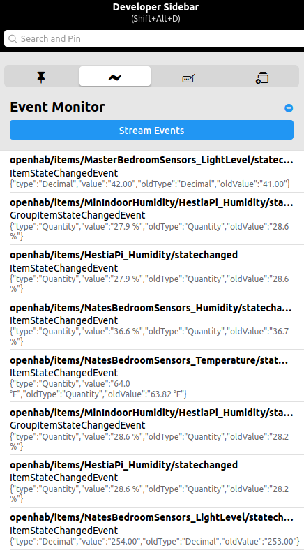

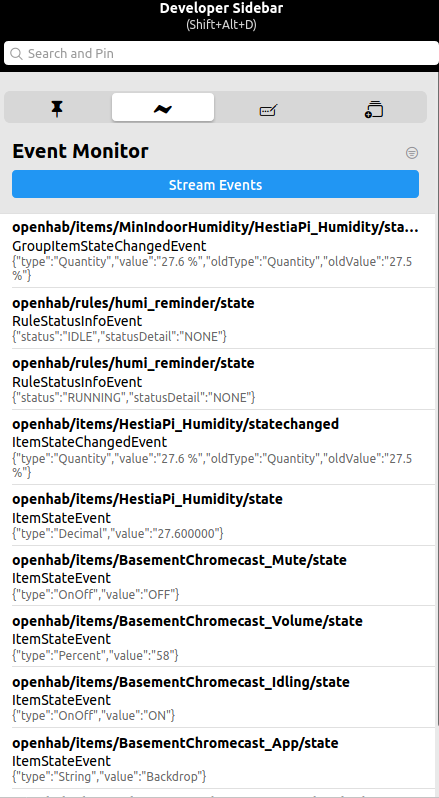

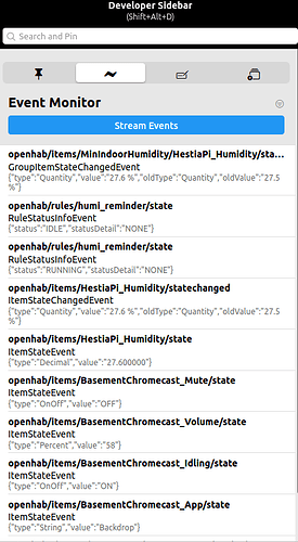

Bring up the Developer Sidebar.
Click on “Stream Events”
You will start to see all the events, the exact same events that get printed to events.log, scrolling by.
In fact, you see more because it also shows Item state updates, and it tells you the type of the update.
If you click on the little filter icon (top right hand corner) you can filter the events to only see those for the Items or event types you want to see. For example, if you put in */statechanged it will only show you the Items that changed state.
You can narrow it down to just those Items and events you care about at the time.
