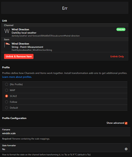

Linking Number:Angle · Point>Measurement item. Done:
Item 'DarkSkylocalweather_WindDirection' changed from NULL to 171.0 °
Linking String · Point item with scale transformation. Err:

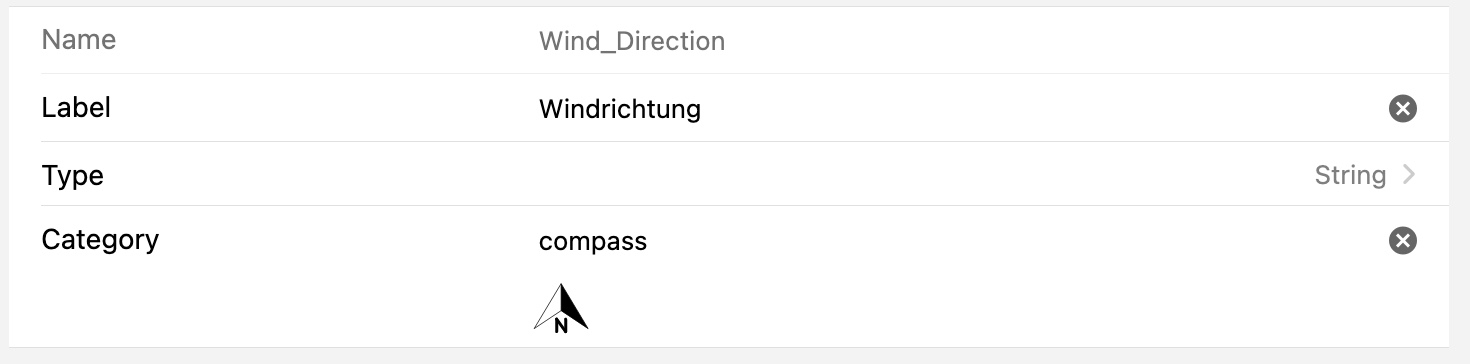

Same issue here, but I defined the item within the MainUI.
The item is linked to the according channel and using a scale file
which is basically identical to one in the initial post here.
Exception while formatting value 'NO' of item Wind_Direction with format '%.0f %unit%': Conversion = 'u'
That is the error message I receive, though the content of the item is correct.
So, where do I fix this in OH3 when an item is created via the MainUI?

Your problem does look the same as @Cybso , although you’ve not shown us the crucial part - the profile you selected for your channel link.

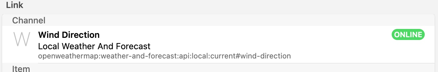

The item is linked as displayed below:
Although “Err” is displayed, the item shows everything correct in the widget.
The linked channel is actually defined as follows,
Reading the bug description, it looks like I pretty much have the same issue.

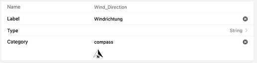

Now changing to the square brackets
I receive the following in the log,
[WARN ] [e.internal.SseItemStatesEventBuilder] - Exception while formatting value '-1' of item Wind_Speed_Beaufort with format '%.1f %unit%': Conversion = 'u'
for me, it helped to set the %s as state formater in the Scale of the thing AND the %s as well as state description in the item.
