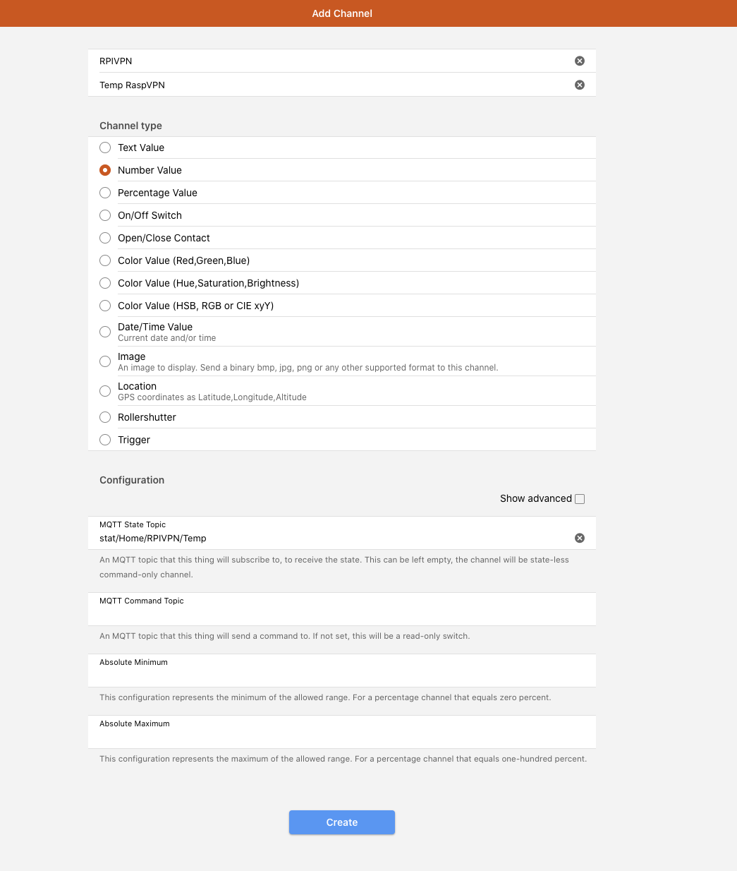

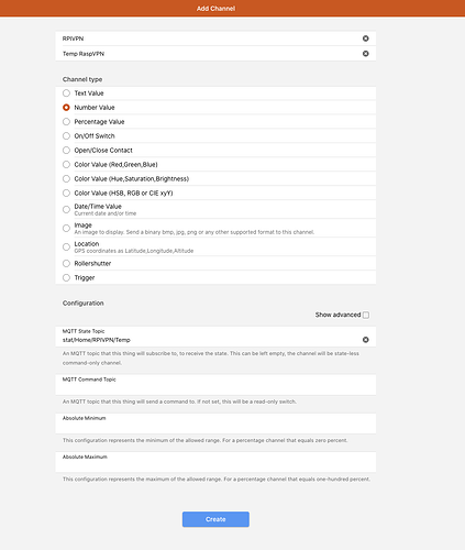

Now after hours of trying I managed it with a litte Python-Skript, that the Temperature of the CPU ist published at MQTT:

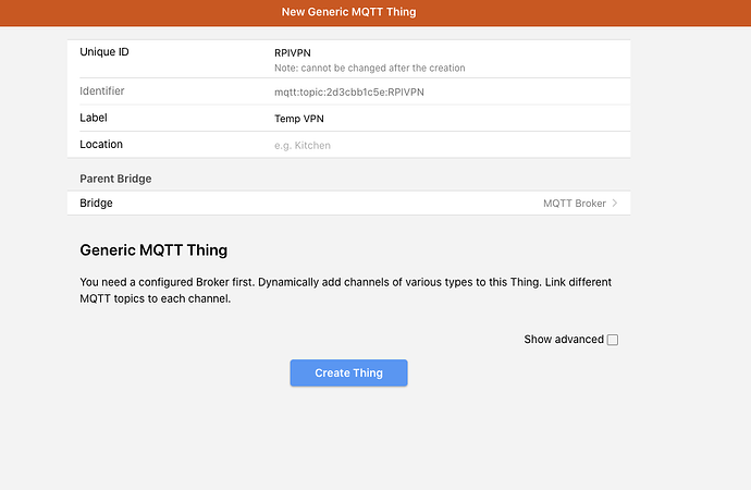

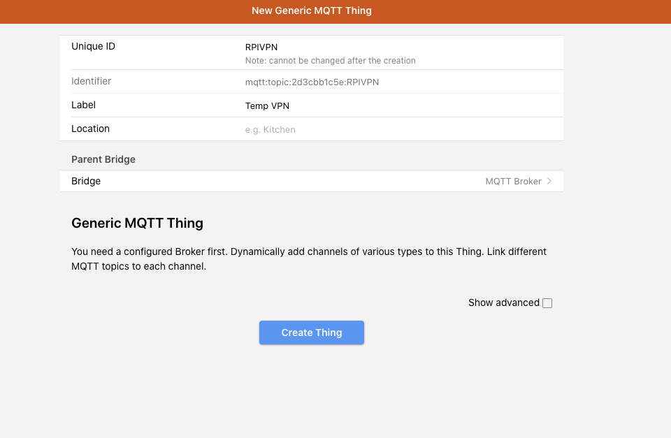

Like you see. But I´m not able to bring it to OH 3. When I´m making a Generic MQTT Thing the result is NULL.
My state topic is stat/home/RPIVPN/Temp - is that true?
Could you please show MQTT setup in OH?
Hope that works
Looking at the image you posted the topic should be
Home/RPIVPN/Temp
Note: case sensitive (you could click the copy icon and paste it into OpenHab)
Perfect thank you it´s working now.

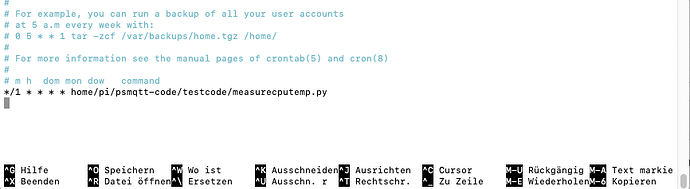

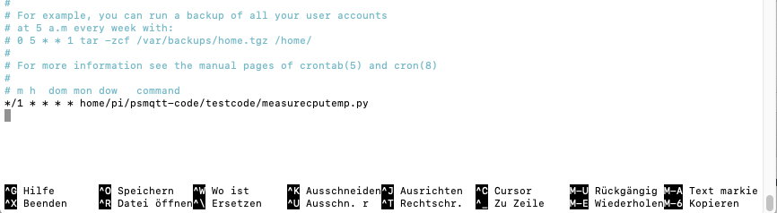

Oh ha - now I´m not able to start the script every minute via cromtab.
I don´t know why
Try ‘/home…’ as this ensures the correct location for the script.
It’s still not working - tried home and home/pi
Anybody knows how to run a python-script via cronjob or where to put the script?
Thanks for help
Just to check, you tried it with the leading / ?
/home/pi/....
