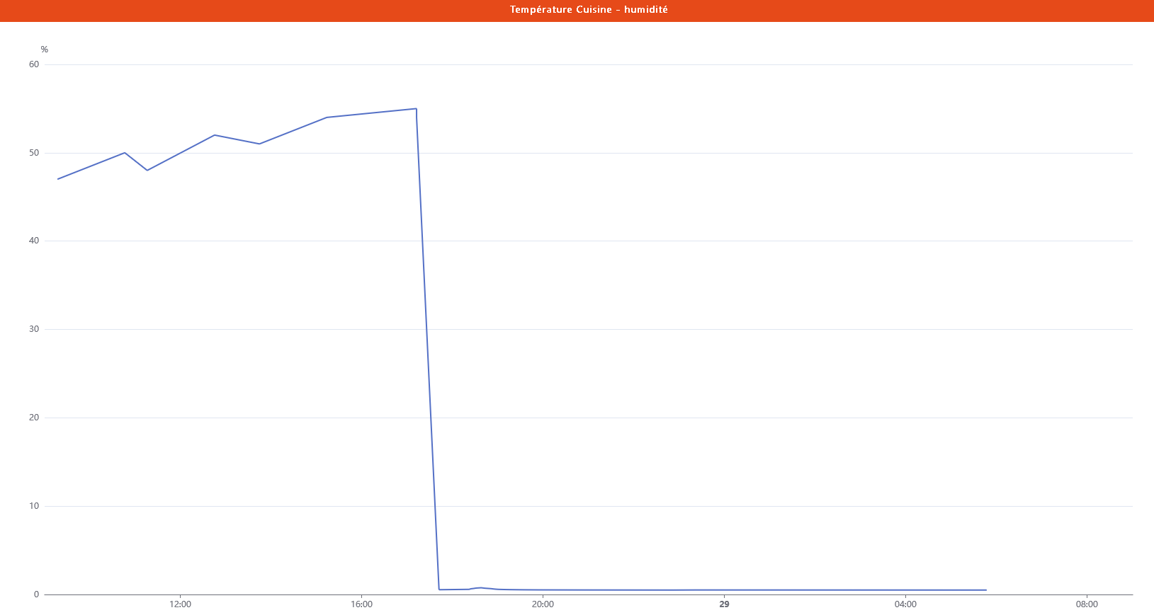

The display still shows a valid percentage value but if I go to the Analyze graph, it’s all squeezed down between 0 and 1.

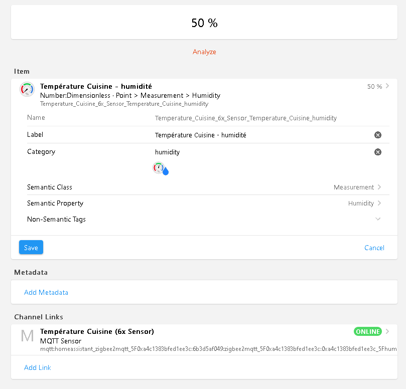

Here is an example with a humidity channel:
The percentage is nice, but if I show the graph, I get this:
The sudden drop is right at the time I migrated to OH4.

But I can’t do this for all other channels as they are not editable at all, as the one shown above which is a “HomeAssistant MQTT Component” thing.
How can I then fix the current situation and get back to a situation where history is properly displayed like it was in OH3?
Add the % unit to the item instead of the thing channel
But I have no control on the Thing channel for most things as they are handled by the binding they come from!

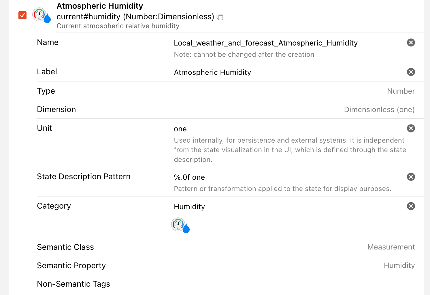

In the case of Dimensionless, the system default is a simple ratio, not percent. So any update sent to such an Item will be converted to a simple ratio.
Since OH 4.1, every place you can create an Item in MainUI, you have the option to set the unit right when you create the Item. If you are using .items files, well you know what you are doing. The field gets pre-populated with the system default so you know what it will be if you choose not to set it.

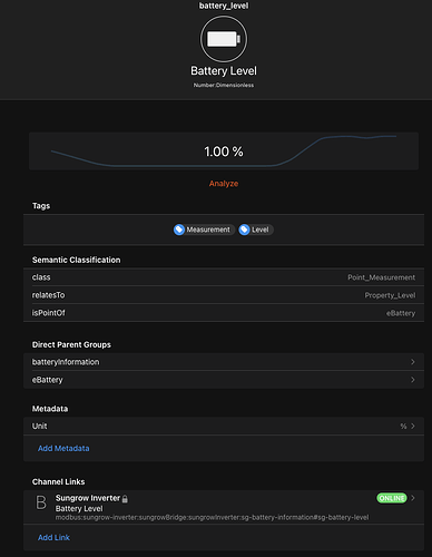

I am having the same (or a similar?) problem in OH4, but even although I have added the unit tag:
Number:Dimensionless battery_level "Battery Level" <oh:batterylevel> (batteryInformation,eBattery) ["Measurement", "Level"] {channel="modbus:sungrow-inverter:sungrowBridge:sungrowInverter:sg-battery-information#sg-battery-level", unit="%"}
The output I see is 1%, not 100%:
What am I missing?
You have unit defined so that’s good. I didn’t use items files though. Maybe you need to escape the unit: i.e. %% ?
Also, double check if this is just a display issue or the Item’s actual state is wrong. You can really see this in events.log.
No using %% does not seem right, then it also shows up that way in the UI.
My events.log shows entries such as:
Item 'battery_level' changed from 1 % to 0.978 %
But are these values before or after OH has processed them?
