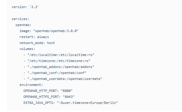

Depending on your docker run command you may have needed to make some volume mapping changes. I assume you at least looked at the documentation on Docker Hub and compared with your OH2 setup. right?
Yup. Can’t say I saw (or see) a difference.
From docs
my compose
Can’t see anything different there?
The second example on Docker Hub show this at the bottom.

but that is only setting the local volumes for the paths doesn’t it? The paths on mine work as it’s managed to load the items (all file-based items) and things etc.
