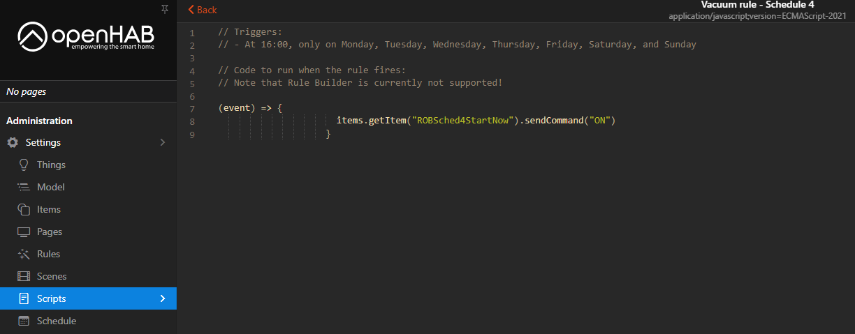

Did notice that when clicking on the rule in the MainUI when the rule is under the rules section that the MainUI jumps to the script section but not sure if that is intended behaviour:

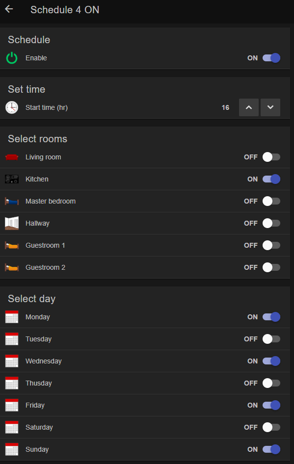

As to my use case, there are currently 4 user configurable schedules for my vacuum cleaner. The user can set the following:
First rule with JSRule creates a new rule with a cronjob that only commands an item to ON with a 1 second expiration timer when any time/day/enable items is changed on the MMI. When the cronjob trigger the item ON it kicks a rule to build the rooms array and start the vacuum cleaner. There is a supporting rule to provide a 3-minute voice announcement if doors must be opened and a subroutine in the script when the house goes to sleep to have a voice announcement for schedules during the night that requires doors to be opened.

Yes, I am aware that is where the type comes from and that may need to be looked into separately. But the reason why it jumps straight to the scripts is because when you create a rule using JSRule it’s created as an unmanaged rule. Unmanaged rules cannot be edited in MainUI so all it shows is kind of read only snippet of the rule. If you define a rule in a .js file it will appear the same in MainUI.

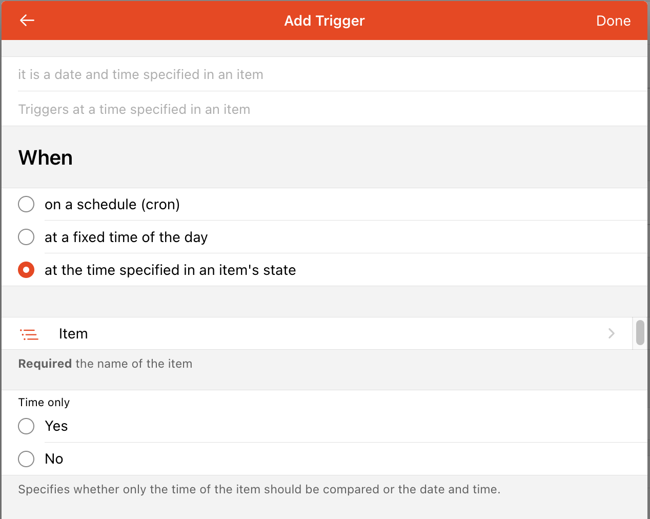

That’s the XY part of the problem. The critical part is to have a rule which triggers based on a user configurable time. A cron trigger is but one among many approaches.
Why not a DateTime Item and a Time is <Item> trigger? There are even date time picker widgets on the marketplace so the users can choose the exact time as well as a new Input widget for Sitemaps which support DateTimes. For the rule, there is an option to only look at the time portion of the DateTime Item’s state, in cases like this where you want it to run every day.
Not really given what we’ve seen in this thread. But it’s even simpler to use a DateTime Item with a Time trigger.

But over all, I still think using a Time is <Item> trigger would be the easiest way to handle this. All you’d really need to do is manipulate the DateTime Items used to trigger the rule and won’t have to mess with Timers at all. You’d still need to do some work though.
  1. Create a proxy DateTime Item to trigger the rule.
  2. Use the trigger that takes into account the date as well as the time on the rule that commands the device using the Item created in 1.

Thanks for pointing again to Time is <Item> rule trigger, my one track mind skipped over it thinking fixed time, not that the <Item> was not obvious enough :slight_smile: . This is indeed the route to take for my use case and will implement next week.
