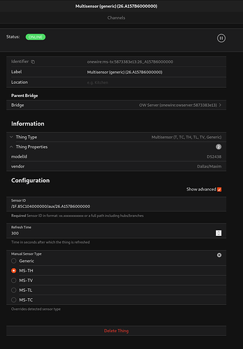

With openHAB 4.1, I have 3 questions that the community can probably help me solve

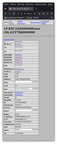

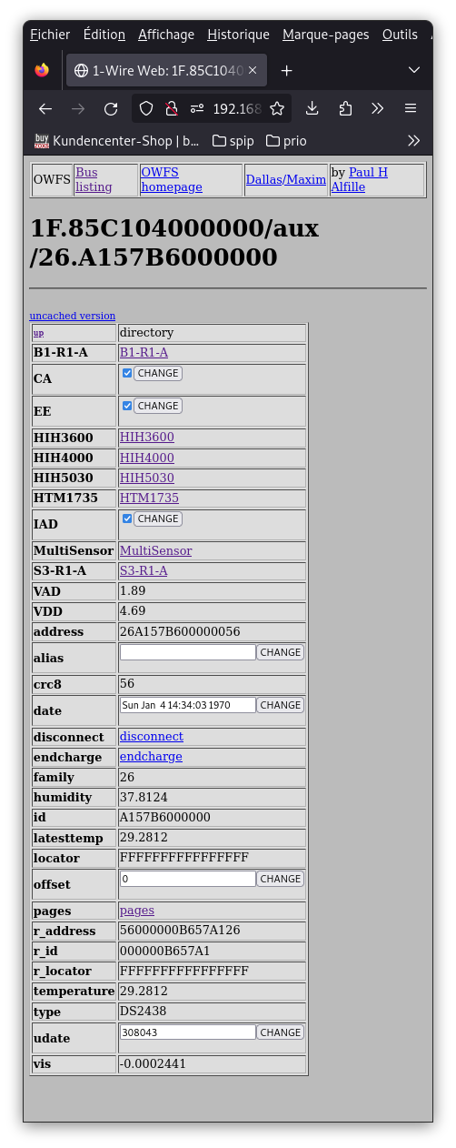

- the channel /1F.85C104000000/aux/26.A157B6000000 doesnāt provide the humidity measurement, even though it is seen by owfs
Module schematic
Moisture Meter v3.0 Schematic.pdf (16.1 KB)
an identical question is reported
https://community.openhab.org/t/humidity-channel-missing-in-latest-onewire-binding/63840
I tested the proposed correction https://github.com/eclipse-archived/smarthome/pull/6835 but without success.

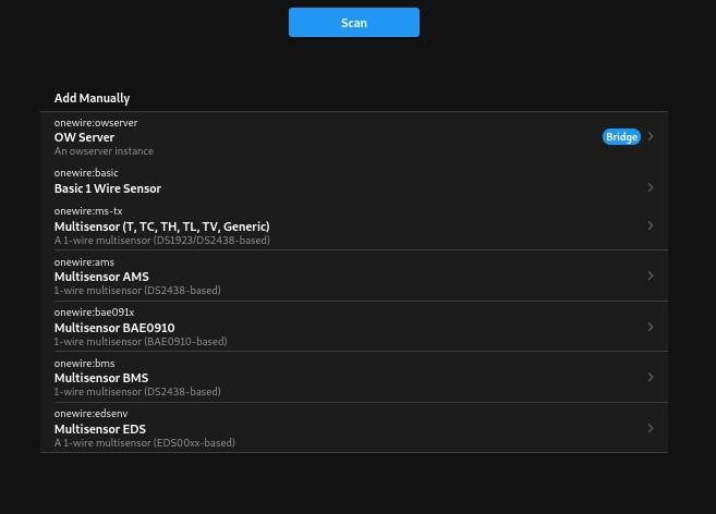

The result of the scan, only Multisensor does not cause a connection error,
I donāt understand what the other things correspond to (Multisensor AMS, BAE0910, BMS, EDS).

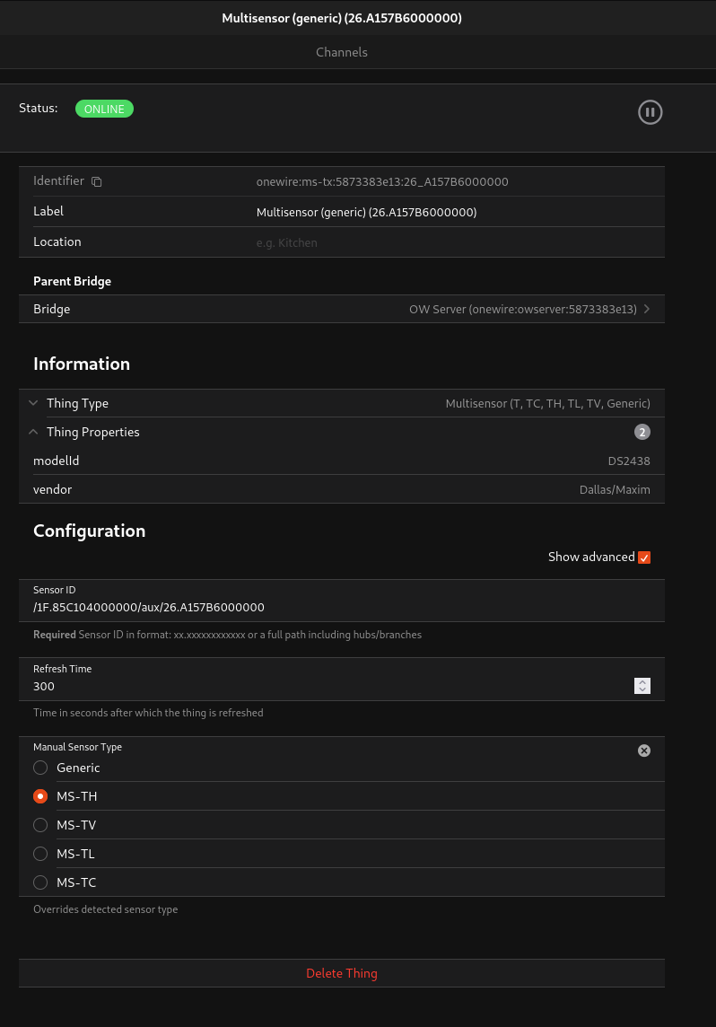

So I added Multisensor (T,TC,TH,TV;Generic)
and created the following 4 objects
- Supplyvoltage
ONLINE
Multisensor (generic) (26.A157B6000000)
onewire:ms-tx:5873383e13:26_A157B6000000:supplyvoltage (Number:ElectricPotential)- Voltage
ONLINE
onewire:ms-tx:5873383e13:26_A157B6000000:voltage (Number:ElectricPotential)- Current
ONLINE
onewire:ms-tx:5873383e13:26_A157B6000000:current (Number:ElectricCurrent)- Temperature
ONLINE
onewire:ms-tx:5873383e13:26_A157B6000000:temperature (Number:Temperature)
But Humidity is missing
UID: onewire:ms-tx:5873383e13:26_A157B6000000
label: Multisensor (generic) (26.A157B6000000)
thingTypeUID: onewire:ms-tx
configuration:
refresh: 300
bridgeUID: onewire:owserver:5873383e13
channels:
- id: supplyvoltage
channelTypeUID: onewire:voltage
label: Supplyvoltage
description: The voltage measured by the sensor
configuration: {}
- id: voltage
label: Voltage
configuration: {}
- id: current
channelTypeUID: onewire:current
label: Current
description: The current measured by the sensor
configuration: {}
- id: temperature
channelTypeUID: onewire:temperature
label: Temperature
description: temperature value of this sensor
configuration: {}
- What do the other things discovered by the scan correspond to??? (Multisensor AMS, BAE0910, BMS, EDS)
