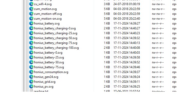

This is the name of the icons:
Also the circle is still acting up, but I wonder if this has to do with the icon beeing wrong?
Hello Kim!
I am sorry it did not work out. The filenames are fine, it’s the conversion of your item value that causes the problems and you are correct, it is the same cause for the dial being displayed incorrectly. Did you try changing the format qualifier as I have suggested?
