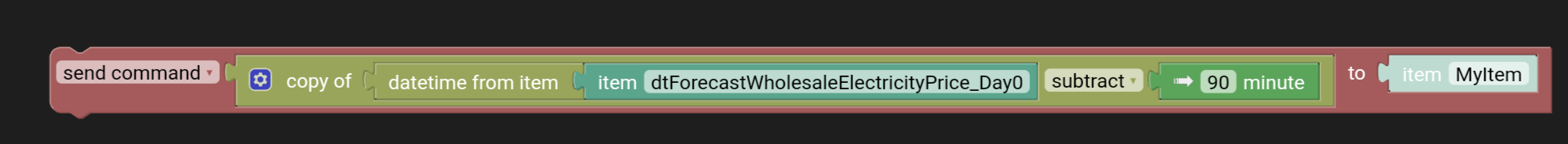

So, instead of the five lines of code required to add 90 minutes to the current state of a DateTime Item:
var minutestosubstract = 90
var timetosubstractfromstring = items["next_outbound_begin"].state
var timetosubstractfrom = new Date (timetosubstractfromstring)
var ETD = new Date(timetosubstractfrom.getTime() - (minutestosubstract * 60 * 1000))
items["ETD_item"].sendCommand(ETD)
we have two
var ETD = time.toZDT(items["next_outbound_begin"]).minusMinutes(90);
items["ETD_item"].sendCommand(ETD);
And those two lines of code requires less mental gymnastics to understand (e.g. .minusMinutes(90) as opposed to - (minutestosubteract * 60 * 1000)).
Since using the time.* classes are going to be required anyway some of the time and using them results in shorter and easier to understand code, using them in most circumstances is better than using the native JS Date class with is far less capable and requires a lot more effort to work with. And it’s going to be converted to a ZonedDateTime for you anyway before it can be used in that sendCommand.
