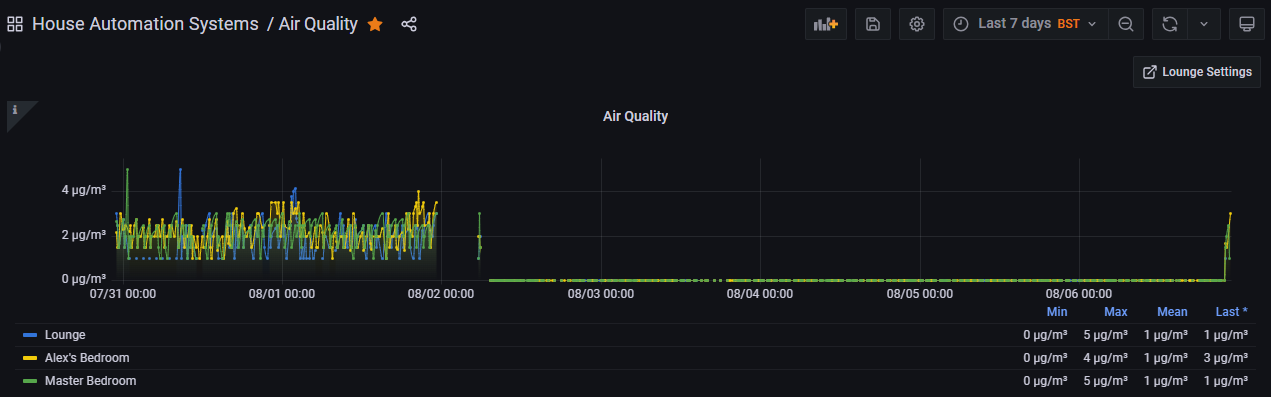

So I finally upgraded our core system to OH4 from OH3. A few days ago. All seemed good - although I finally noticed one minor thing due to the units now getting normalized in OH4.
So the blank part 08/20 00:00 is when the servers were offline for disk imagining - prior to the backup - just in case snapshots failed, etc… no issue.
Then there’s a blip where it kicks in with OH3 before the OH4 upgrade is run.

In 3.4 this showed and persisted the units as µg/m³
Upon upgrading to v4. The units became kg/m³. So the units no longer pass through what the binding specifies in code, but go “may be incorrectly named by me” a normalized base unit. Hence it gave the persisted data as shown in the original post.
Of course when it was µg/m³ changing to kg/m³ means rules using µg/m³ won’t work as they are now evaluating against a different persisted value.

P.S at the end of the original graph on the first post (the values started coming in as unit has then been set as updated in the docs).
Right. So no unit is specified. Therefore the default unit for that unit of measurement type is what gets applied.
Previously, given no other information, the unit in the state update was applied so what came from the Channel was passed through. Now the value is always converted (if necessary) to the unit of the Item. When unit metadata isn’t defined that base unit is going to be the system wide default for that UoM.
Persistence saves the state of the Item without units. It just saves the number. One of the problems that arose with the old way that was fixed in 4.0 was the following scenario (among others). Let’s say you have a Channel that publishes °C. The Item’s State Description Pattern is set to show the Item as °F. In this scenario the Item’s state is °C so that’s what gets saved. However, on restoreOnStartup the only unit that is known at that point is the State Description Pattern so that 22 °C gets restored to the Item as 22 °F and until that Item gets updated from the Channel again, it’s going to be wildly off.
