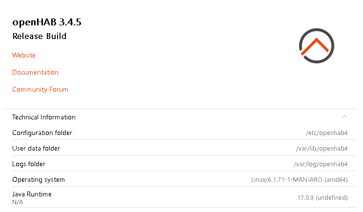

But if I go to http://myserver:8080/about/ I still see the version being 3.4.5 as before:
Clearly, I have missed something here, but clearing the browser cache nor using another browser did change a thing.
So I went on to remove the cache and tmp folder content from the /var/lib/openhab4/openhab4 folder and after having restarted the service, this time the About web page shows 4.1.1 as does the console.
