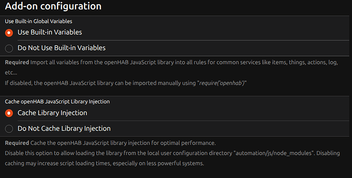

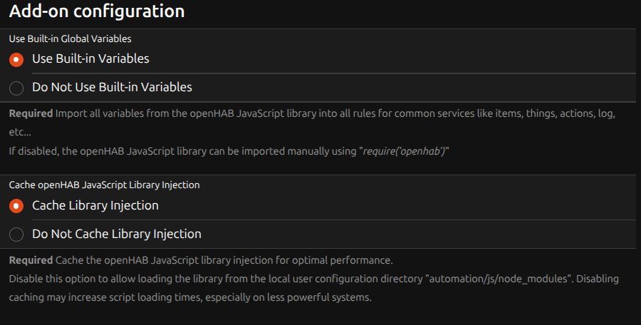

I had the same error ( js transformation didn‘t work), rule engine was not running. I removed the js scripting add-on , did a restart of the docker container OH snap 4801 , reloaded js scripting add-on and change to ‚auto inject all scripts‘. Now it‘s working fine.

But the rules engine seems to start ok, and I have tested a number of rules and they actually seem to work ok.
All my rules are UI-Based (No file based rules at all). JS Add-on settings are as follows:
I have tried removing and re-adding the JSS add-on as well.
