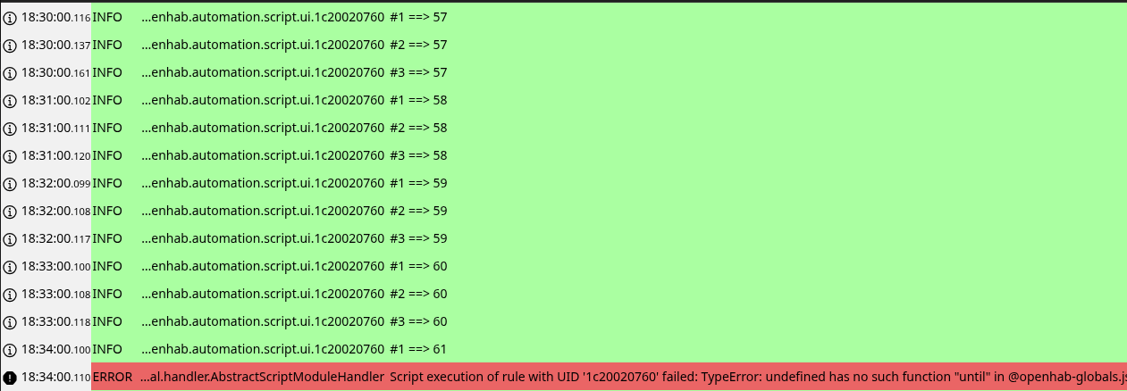

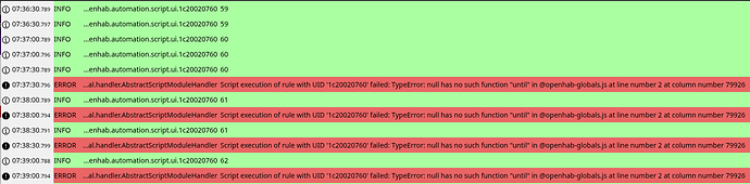

When the minutes are greater than 60, an error appears in the LOG.
Only if I use function:
OH_Persistence
I tested with the following Rule
Log Viewer
Error Detail only when minute is > 60
Script execution of rule with UID ‘e70053bcbc’ failed: TypeError: null has no such function “until” in @openhab-globals.js at line number 2 at column number 79926

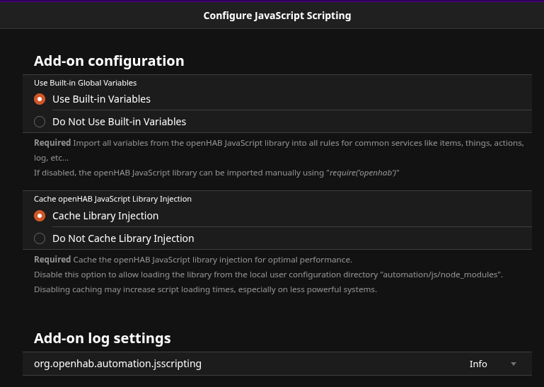

Do you have more than two options under Settings → JS Scripting for “Variable injection”? If so, try changing that option (e.g to “Auto injection for UI based rules and transformations”), and then open and save the rule generating the error. Does that seem to help?
If you only have two options there I’m not sure what else to try. Maybe just saving the rule to regenerate it will help?

The error only occurs when the number of minutes is greater than 60.

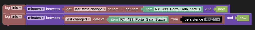

There are 2 calculations for “minutes between” the one that fails is from the Persistence block.
As you can see every minute appears twice one for each option.
The one from Item block keeps running after 60, 70, 120 minutes, etc.
But the block from Persistence stops and gives me an error as soon as the number of minutes is above 60.
There is no error from 0 to 60 minutes.

Hi Rick!
This is what I have under Settings → Add-On Settings → JS
The error only happens when number of minutes is Greater than 60!
All counts from 0 to 60 have no errors.
Click on the code tab and post the JS code.
Use code fences.
code goes here

As soon as the value is above 60 (minutes in this case) there is an error.
Only the first part of the code (#1 ==>) keeps running after 60 minutes.
