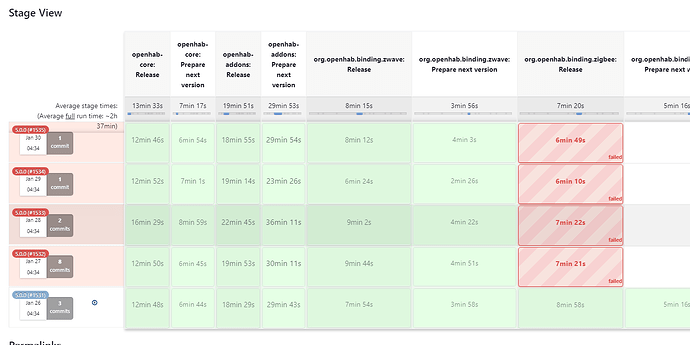

Not sure who to address this to now - but the Builds are failing again - My previous thread is closed so could not just tag in on to the end.
Mark
In logs:
[ERROR] Failed to execute goal org.apache.maven.plugins:maven-compiler-plugin:3.13.0:compile (default-compile) on project org.openhab.binding.zigbee: Compilation failure: Compilation failure:
[ERROR] /var/jenkins_home/workspace/sandbox-openhab5-release/org.openhab.binding.zigbee/org.openhab.binding.zigbee/src/main/java/org/openhab/binding/zigbee/discovery/ZigBeeNodePropertyDiscoverer.java:[141,25] Null type mismatch: required 'com.zsmartsystems.zigbee.zcl.@NonNull ZclCluster' but the provided value is null
[ERROR] /var/jenkins_home/workspace/sandbox-openhab5-release/org.openhab.binding.zigbee/org.openhab.binding.zigbee/src/main/java/org/openhab/binding/zigbee/discovery/ZigBeeNodePropertyDiscoverer.java:[246,25] Null type mismatch: required 'com.zsmartsystems.zigbee.zcl.@NonNull ZclCluster' but the provided value is null
Started failing 27.01.2025, but I don’t see anything merged in the Zigbee binding repository for the last two weeks, so something else must have triggered it.
