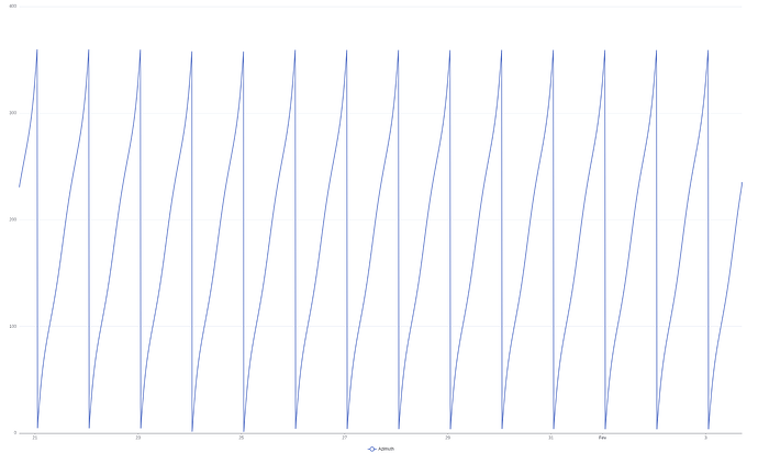

I’m also on 5.2.0, build 5142 and Azimuth does not appear to have changed in its behaviour :
