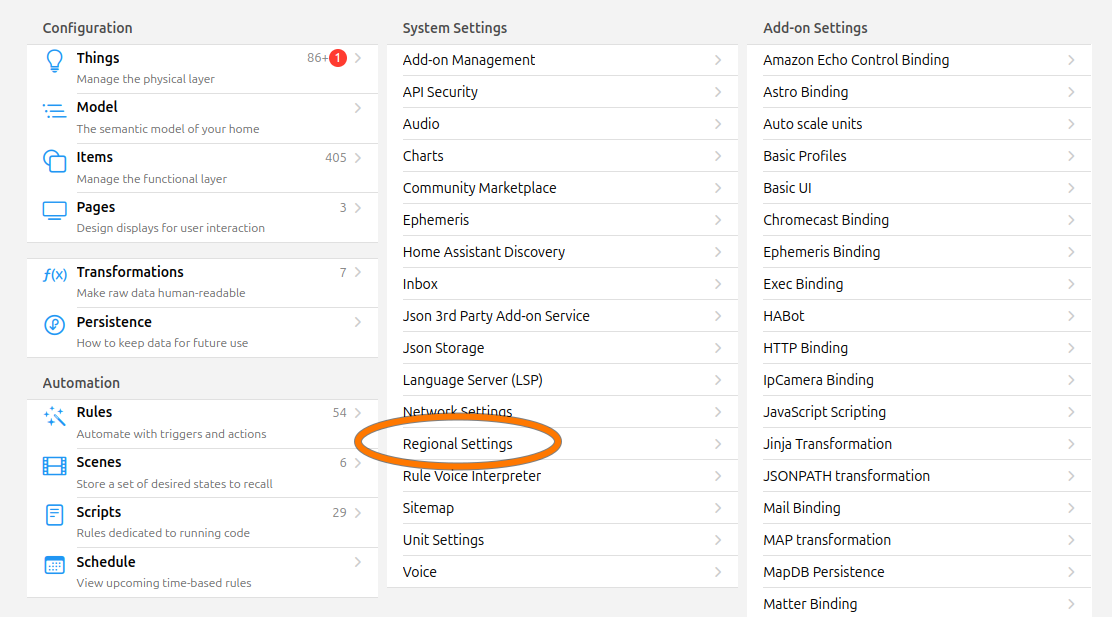

While point 2 (Java config in /et/default/openhab) did the trick for me too, my MainUI does not show any “Regional Settings” under Settings though.
kind regards
Chris
It’s a core configuration. If it’s not there something is really wrong with your OH install.
You opened my eyes. :zany_face: Thank you once more!
