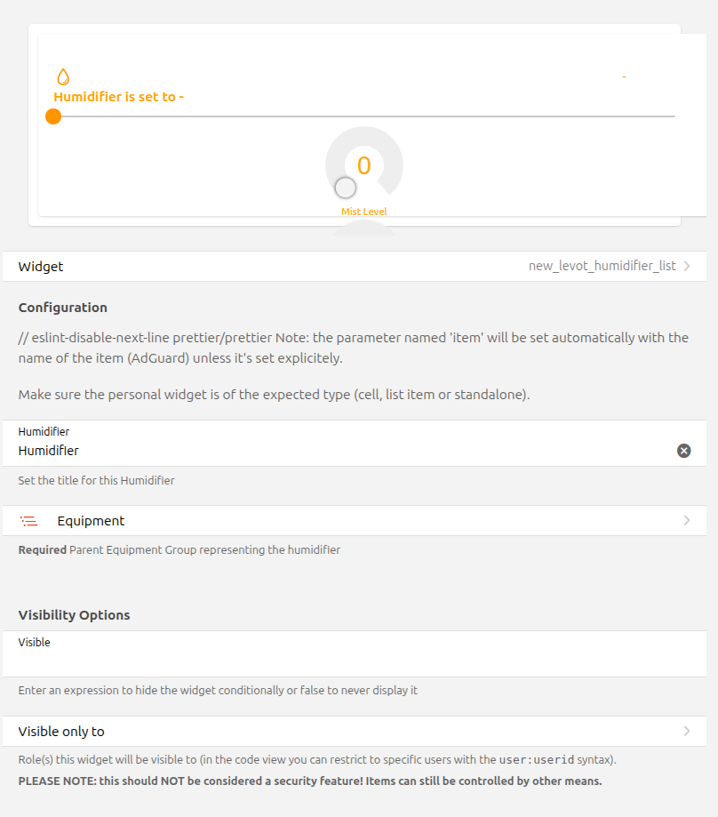

However, if you want to make a widget more generic and usable more than once you need to code it more generically. This means you need a way for you and other users to supply information for the widget at the time you apply it. This information are the properties.
For example, we have that humidifier widget I posted above. I have two of these humidifiers so I chose to use a generic approach which means defining properties. In this case I want to supply the title for the widget so I know which humidifier it represents and the parent Equipment Item. I derive the names of all the rest of the Items based on the parent Equipment Item.
In the code that looks like this:
props:
  parameters:
    - default: Humidifier
      description: Set the title for this Humidifier
      label: Humidifier
      required: false
      type: TEXT
    - context: item
      description: Parent Equipment Group representing the humidifier
      label: Equipment
      required: true
      type: TEXT
And when I set the widget on an Item’s Default X Widget metadata or on a Page directly I’ll get a form with two options.
Notice how the Equipment property is an Item picker. What sort of field is rendered for each property is controlled by the context field of the property. You’ll see I set the context to “item” which tells MainUI I want an Item picker instead of just a plain text entry field.
I could further narrow things down by setting a filter so it only shows Items of the desired type (e.g. only Switch Items) but I find that’s often ignored and all Items are shown even with the fiter.
There are lots of contexts available which provide things like a time picker, map to select a location, booleans, enumerated values, etc. The code that handles properties is the same that handles properties for Things and binding configs and you can find that documented at Configuration Descriptions | openHAB.
I’ve also an example rule template in the marketplace (unpublished) that has examples for almost everything in that table to see how that table applies to the YAML used by widgets and rule templates. [Do not install] Rule Template Parameters Experiments and Examples.
You can control whether the property is required or not and if it’s not required provide a default value.
That covers how to define a property and why you might want to do that. But how do you us a property in the widget code?
It’s actually pretty simple. All the properties are stored in an Object called props under the value entered for the name field of the property. So, for example, to reference the user chosen value for property I defined above with the name “title” I simply use props.title. To reference the user chosen value for the property I defined above with the name “equ” I simply use props.equ.
