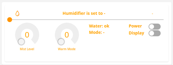

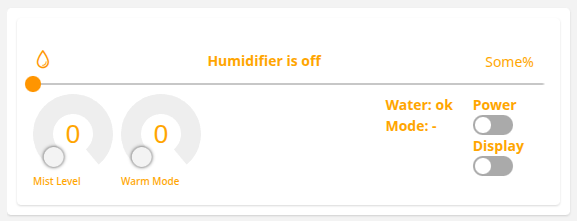

A concrete example might be worthwhile for discussion purposes.
There are warnings about not overly nesting the cols, rows and block because of performance, but what is too much? What’s the alternative?

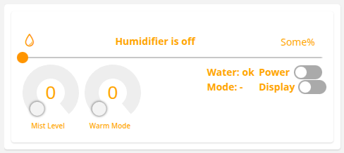

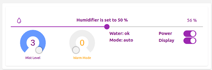

I had an old widget that was pretty hard coded with lost of absolute positioning. I’ve recently tried to rewrite it using best practices, and I am not at all happy with the results.
Here’s the code.

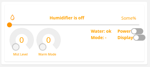

What I don’t like and haven’t figured out how to address:
  • How do I get rid of that space at the top? Alternatively, how do I set the block title if I can’t get rid of that space?
  • Can I get the icon all the way to the left so it lines up with the start of the slider?
  • Same for the percent in the upper right.
  • I want the two arcs to remain close together pinned to the left when it resizes and the label and toggles to stay together at the right when the widget resizes. But everything spreads apart.

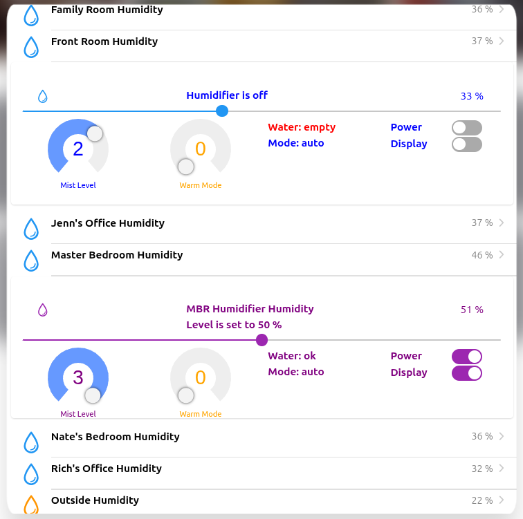

  • This widget doesn’t seem to display consistently on the pages. I think it has to do with the hard coded height. How do I make it consistent? I had to make the height larger than necessary to keep the bottom of the second widget from overflowing into the widget below it. This may be a more specific question since this is an odd widget being used in a list card.
I feel like I’m really close to having a good understanding and then when I try to apply my understanding, either things don’t change at all or change in unexpected ways which shows I don’t really understand.
Any advice for MainUI Widget experts would be most welcome. I’m not necessarily looking to fix this specific widget as much as I am looking for understanding which I can apply to my other widgets and helping on the forum going forward.

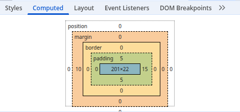

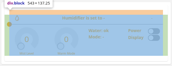

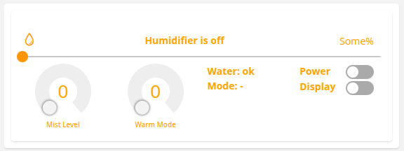

So applying all this to your example questions about the widget. Here’s my process:
The first thing I’m going to do is bust out the dev tools and see if I can identify that space:
That tells us it’s the top margin of the block element that is inside the card contents. So, first we check if we can override that the easy way:
- component: f7-block
    style:
      margin-top: 0
Success!

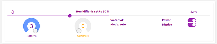

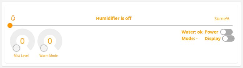

These are part of the same answer. Here you’ve over-used the f7-col and and f7 classes (and added some absolute positioning as well):
You want the children within this f7-row to stretch fully from end to end. With flexbox (which the f7-row is by default) the justify-content: center; css directive tells the flexbox to try and squeeze all the child elements as close to the center as possible. The only reason you don’t see them all adjacent is that you have put them in cols which adds a bunch of automatic size and spacing.
Following the philosophy of getting out of the way and letting the flexbox do the work, I recommend the following:
  1. Get rid of both the classes on the row: space-between is the default justification setting for the row and that’s what you want here and start is already the item align for the row as well.
  2. Get rid of all 3 cols: you have a precise idea where you want these child elements (fully left, center, and fully right) and you don’t want the cols making extra decisions on size and spacing that will interfere with that.
  3. Get rid of the top, right, and position style settings on the chip: any child elements with absolute positioning will ignore the position directives from the flexbox parent and you want the parent to set the position here.

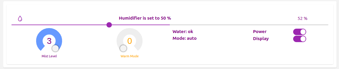

Those changes result in:
This is just a basic web dev structure thing. Again, you’ve over engineered the row and columns when you just really need one container every time you want two or more things to share some organization:
  1. you want the power label and it’s toggle to remain side by side: sounds like a row → f7-row1
  2. you want the display label and it’s toggle to remain side by side: sounds like a row → f7-row2
  3. you want f7-row1 and f7-row2 to be stacked vertically: sounds like a column to me → f7-col1
  4. you want the water and mode labels to be stacked vertically: another column! → f7-col2
  5. you want f7-col1 and f7-col2 to remain side by side: another row → f7-row3
  6. you want knob1 and its label stacked vertically: column → f7-col3
  7. you want knob2 and its label stacked vertically: column → f7-col4
  8. you want f7-col3 and f7-col4 to remain side by side: another row → f7-row4
  9. you want f7-row3 and f7-row4 to be spaced automatically across the width of the card: flexbox time! → f7-row5
So that looks like this structure-wise:
f7-row (#5)
  f7-row (#4)
    f7-col (#4)
      knob
      label
    f7-col (#3)
      knob
      label
  f7-row (#3)
    f7-col (#2)
      label
      label
    f7-col (#1)
      f7-row (#2)
        label
        toggle
      f7-row (#1)
        label
        toggle
Here’s the result of that structure with absolutely no additional classes or setting on any of those rows or columns:
Pretty close! Looks like we just have a little bit of tweaking to do. I see two issues to start with:
  1. we want the knob labels centered: that’s easy to fix. The labels are already centered in the column (you can check dev tools to verify this) but the text isn’t centered in the labels, so we just add text-align: center to the label styles:
  2. The rows that hold the toggles and their labels shrank so much that flex box decided it was easier to split into two rows: also an easy fix. We can use flex-wrap: nowrap to tell those rows to always be only one row.
Almost there! The toggle + labels are a little off. We;d like some space between them and we don’t want the lower one to push beyond the edge of the card.
  1. The space issue is easy. Flexbox comes with a gap property that gives a consistent space between all children. So in this case well add gap: 5px to the styles of the rows that hold the toggles and their labels.
  2. the position of the lower row is a little trickier. Flexbox has made a poor choice about how to space and size it’s child columns. The basic answer is that we need the felx box to preserve a little more space for that last column. There are enough different flexboxes (f7-rows) in this structure that we have a couple of choices, but I think the most direct one is to tell the columns on the right side to be slightly different sizes. In this case we want the column holding all the toggle pieces to expand more than the column holding the simple labels. flex-grow is the css to determine what proportion of the available space a flex child item takes up (with the default being 1). So if we set that last column to flex-grow: 1.5 it’ll be a little larger and the toggles will fit.
Looks great! And is fully responsive to size:
Of course there are still many things we can continue to tweak until it’s perfect. Maybe you want more space between the water/mode labels and the toggles. Identify the correct row container and add a gap style. Maybe you want more space between the top row and the bottom row on the right side. gap works for flex columns too (just make sure you add it to both those columns)…etc.
*This is not the only structure that solves this arrangement. The right side could also be just one column with two rows and each row has two sub rows which hold a label and a label + toggle respectively. Or you could go with a css grid…or…etc.

What tells us that? The fact that it’s colored orange instead of green or blue (are the margins color coded)? And once I do know it’s the margin, I can figure out how to change that by looking at the Typography link above, right?

Ok, I can see that I did make a couple of jumps there for users less familiar with the dev tools panel. Here’s the little background (for chromium browsers, at least, although I assume that others are fairly similar).
Yes, the element’s space is color coded. When you are using the elements tab in dev tools, you can select any html element in the page either by clicking on the element in the html viewer on the pane or using the inspect function (context menu or image button). When you hover over an element with the inspect function, or hover over the element’s html in the panel, the browser puts an overlay on the element itself to show the size, padding, and margins of that element:
The basic colors correspond to the detailed size and position display which is found in the computed css tab of the lower half of that elements panel.
(the last fill in the overlay, the purple with diagonal hash-lines is space the element is assigned that is unused by it’s child elements).

Something like:
  1. I want to make a widget to consolidate all the information about my humidifier
    a. list some requirements, maybe include a hand drawn sketch
  2. Build the initial widget applying the “bare minimum” principal
    a. be sure to talk about properties
    b. be sure to talk about oh-context
  3. Ugh, it doesn’t look right, identify all the things we want to change and walk through the steps to fix them for each identified thing to fix
    a. figure out what part of the widget needs to be adjusted, here is where you bring up the web developer tools in the browser
    b. figure out what to change based on 3.a. (links to reference docs and a little discussion about how to use them)
It’s the process that needs to be presented, not all the reference details. It’s the context that is missing. We are working in OH but pointing to the F7 docs and CSS reference docs et. al. loses that context. I follow the link and immediately get lost because nothing told me how to apply the information I find there to YAML in the OH context.
I’m really not looking for that. I’m, more looking for process and the secret decoder ring for how to use the external reference docs and apply them to OH.
The widget I posted would be a good candidate I think. It’s just interesting enough to need a little extra work to make it right but not so complicated that we need to get too deep in the weeds.
