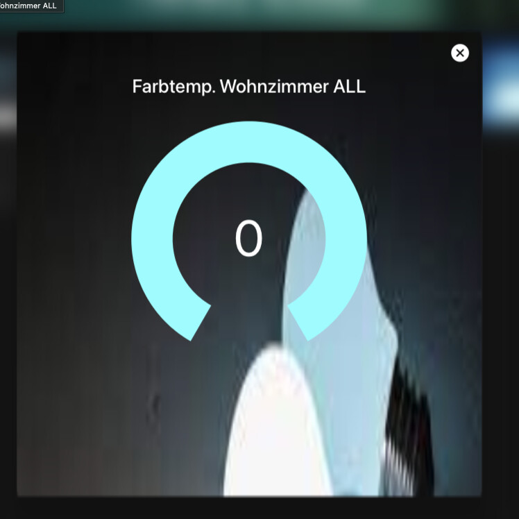

Do you have an idea how I can say the image should only display on label widget but not in the popup window ? thank you
Add
class:
- card-opened-fade-out
to your oh-image config

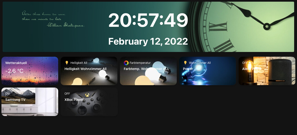

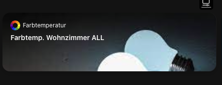

This the result, thank to you for helping me.
