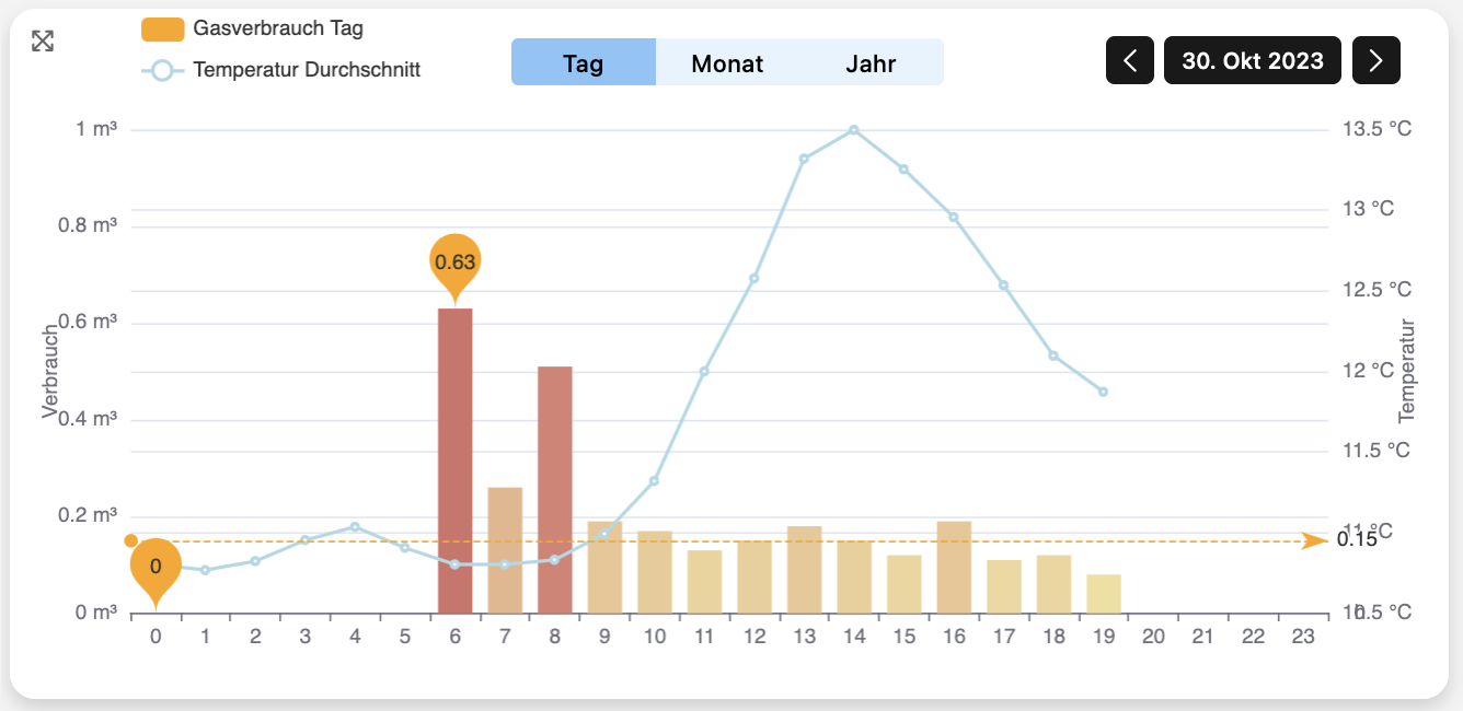

I try to build a Chart diagramm with variable chartType, changing the chartType using a button action, however it doesn’t work as expected.
I tested different formats, but none of them are working in OH4.0.3.
I tried the following syntax in oh-button config, using for example month
or year
as chartType.
- component: oh-button
action: variable
actionVariable: varPeriod
actionVariableValue: "[chartType: month]"
action: variable
actionVariableValue: "month"
action: variable
- chartType: "year"
In oh-chart I assigned the vars.varPeriod
variableValue as chartType
- component: oh-chart
chartType: =vars.varPeriod
Is the the wrong approach to change the chartType, or is the syntax I use wrong?
Thanks for a hint
Stefan

Historically, not all configuration options of the charts where evaluated by the expression parser. Most of them have been reworked by now so they can be expressions as well. It is possible that chartType
simply is one of the few remaining that cannot be set to a dynamic value.

Many thanks Justin,
is it possible to get this feature added? Or do you have a better approach than the workaround I use?
Currently I replicate the oh-chart
section for every view I want
It works well, but it is not a very efficient way of coding a page.
Many thanks

You can always file an issue on the ui repository. That’s no guarantee, but it’s the best way to make sure that the ui devs know this feature lacking.
