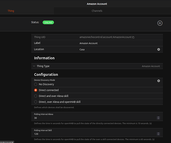

This is my “Amazon Thing” configuration:
What about yours?
Mine is “Direct and over Alexa Skill”
Bridge amazonechocontrol:account:account1 "Amazon Account" @ "Accounts" [discoverSmartHome=2, pollingIntervalSmartHomeAlexa=10, pollingIntervalSmartSkills=120]
Thank you. Here I have no skills installed. Maybe I need one of them.
Do you have OH Alexa skill installed?
