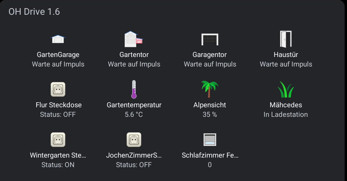

Current features in version 1.6
  • Dynamic loading of selected openHAB Sitemap entries
  • Android Auto grid layout with large buttons and icons
    The icon are here listet with their names:
    Icons | openHAB
  • Display of sensor values, temperatures, weather information and other Item states
  • Switch controls with visual command feedback
  • Special impulse handling for relay-based controls

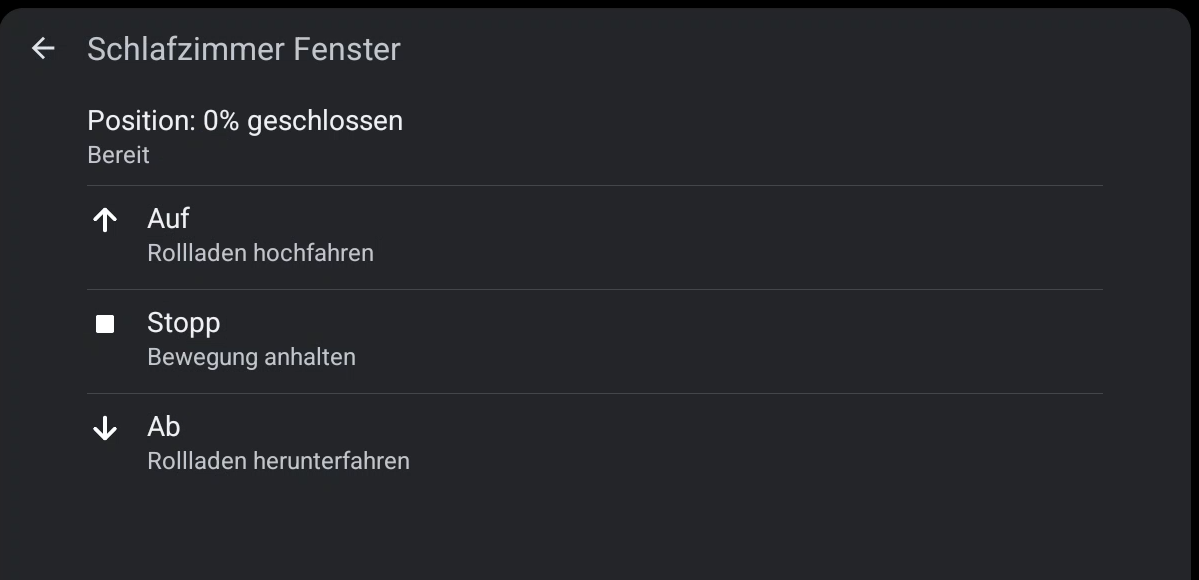

  • Roller shutter submenu with Up, Stop and Down
  • Automatic roller shutter position updates approximately every two seconds while the submenu is open
  • Live monitoring of configured relay events
  • Visual command feedback: orange hourglass, green checkmark and red error symbol
  • Automatic German/English interface language selection based on the Android system language
  • Custom Sitemap labels are preserved exactly as configured by the user

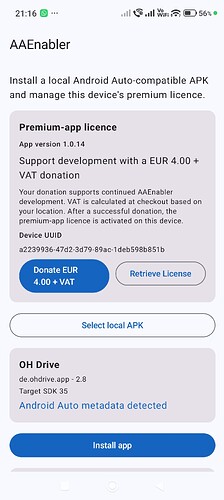

OH Drive is currently distributed as an experimental APK, not through the Google Play Store.
For my setup, installation requires AA Enabler to make the application available in Android Auto.
General procedure:
  1. Download the OH Drive APK.
  2. Install it using the AA Enabler procedure.

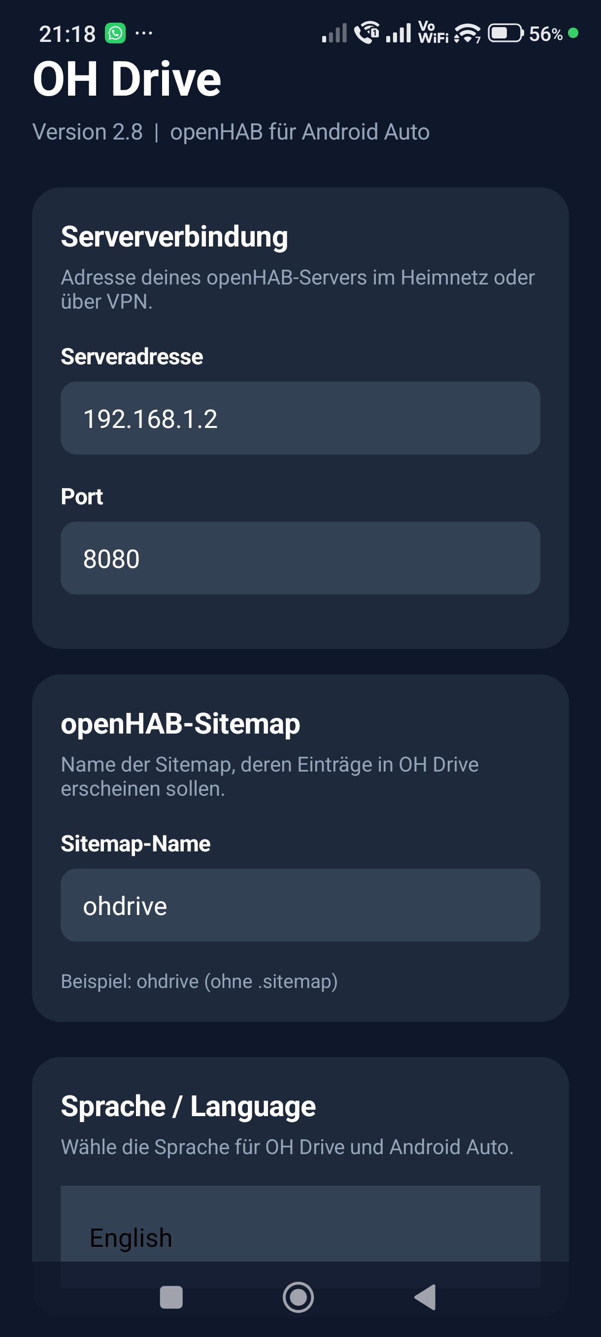

  3. Configure the connection to your openHAB server.
  4. Create the dedicated ohdrive.sitemap.
  5. Start Android Auto and open OH Drive.
AA Enabler is a third-party tool, is not included with OH Drive, and may be restricted or blocked by Android or Google Play Protect. Compatibility is not guaranteed and depends on the Android and Android Auto versions.

New in version 1.9 – Rollershutters and awnings
OH Drive now supports different display and control descriptions for rollershutters and awnings, even though both use the standard openHAB Rollershutter item type.
The distinction is configured through an optional OH Drive-specific marker in the sitemap label.
For example:
Rollershutter:
Slider item=LivingRoom_Shutter label="Living Room Shutter [%s]" icon="rollershutter"
Awning (0% = open, 100% = closed):
Slider item=Terrace_Awning label="Terrace Awning [ohdrive:markise:0offen] [%s]" icon="rollershutter"
Awning with reversed percentage interpretation:
Slider item=Terrace_Awning label="Terrace Awning [ohdrive:markise:100offen] [%s]" icon="rollershutter"

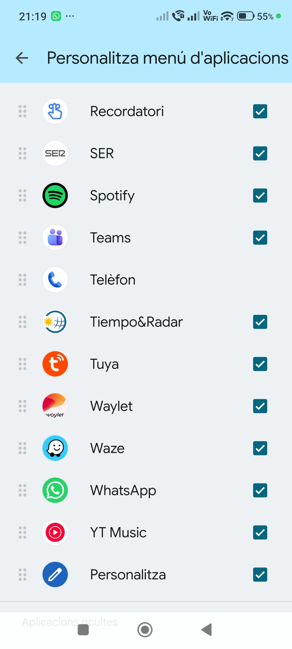

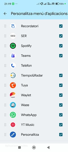

I have installed with no problem… but I don’t understand german… so… I don’t know what the app is saying to me :frowning: :sweat_smile:
On the other part, I have put the myopenhab cloud as server, but it doesn’t work and there aren’t any place for auth… so, I think that actually only works with local no auth or some VPN. Is that true?

I will explain my test. My phone is a Xiaomi 14T Pro, I have installed version 2.7 of OH Drive using AA Enabler. All works correctly during installations.
My phone uses catalan as primary language, also spanish and english as prefered languages, but OH Drive appears on german language, so I don’t know what it says :sweat_smile:. I have created a sample sitemap bassed on documentation sample but using my items.
I have put my local OH server on OH Auto configuration, it seems to work as “Verbindung prüfen” display a “green message” (Although I use OH cloud, also have Tailscale, so I think could use it outside local network).

You need to have access from your mobile via classic IP adresses.
e.g. 192.168.0.10 is your OH server, use this IP in OHdrive as your server IP.

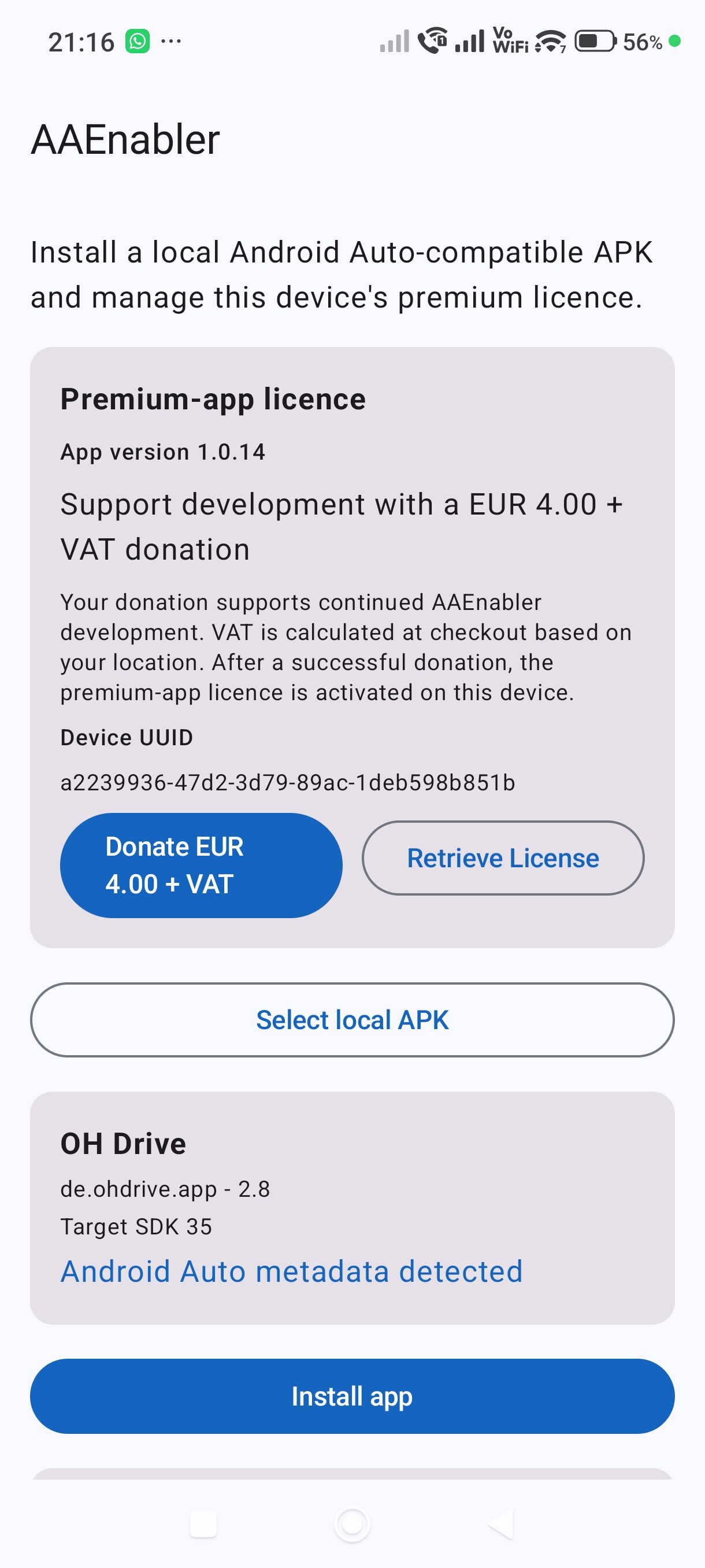

Overseen, that you have already installed via AAenabler…
Have you enabled your AA in developer mode, and have selected, allow unknown sources?
I will try the new version later, thanks.
And yes, I have installed using AA Enabler with no problems (my phone has developer mode because I teach .NET MAUI and tests apps in my phone).
Can I check something more?
I send you some snapshots.
Installed again with AAEnabler. The language selector didn’t work for me neither closing and reopening it. And continue without appearing on Android Auto allowed apps.
Please try with 2.8, but this will solve your not visible problem in AA launcher.
Perhaps ChatGPT could help here…
For me it works with A16 on my older SG23U.
As you can see on snapshots… last test was with 2.8 :frowning:
Maybe is mandatory to bought AAEnabler licence to work it?
First of all, thank you very much for testing OH Drive and for providing such detailed feedback and screenshots! I really appreciate your help.
I’ve investigated the Android Auto visibility issue and found something interesting in the AAEnabler GitHub project.
It appears that AAEnabler can successfully recognize and install an Android Auto-compatible APK without necessarily guaranteeing that Android Auto will display the application.
There are also reports of similar problems on Xiaomi devices running HyperOS, where applications installed through AAEnabler do not appear in the Android Auto app launcher.
This could explain what you’re experiencing with your Xiaomi 14T Pro running Android 16 and HyperOS 3.
Could you please check one thing?
In Android Auto’s developer settings, make sure “Unknown sources” is enabled. This is different from the regular Android setting that allows APK installation.
If it is already enabled, the issue might be related to Xiaomi’s installation process or HyperOS restrictions rather than OH Drive itself.
I’ve also identified the language issue you reported. OH Drive 2.8 introduces German and English language selection, but your screenshots suggest that the selected language isn’t being applied correctly to the settings screen. I’ll investigate this for the next update.
For unsupported system languages such as Catalan, OH Drive should automatically fall back to English rather than German.
For now, I don’t want to change the Android Auto integration without understanding the underlying issue.
Thanks again for your support and for helping improve OH Drive!

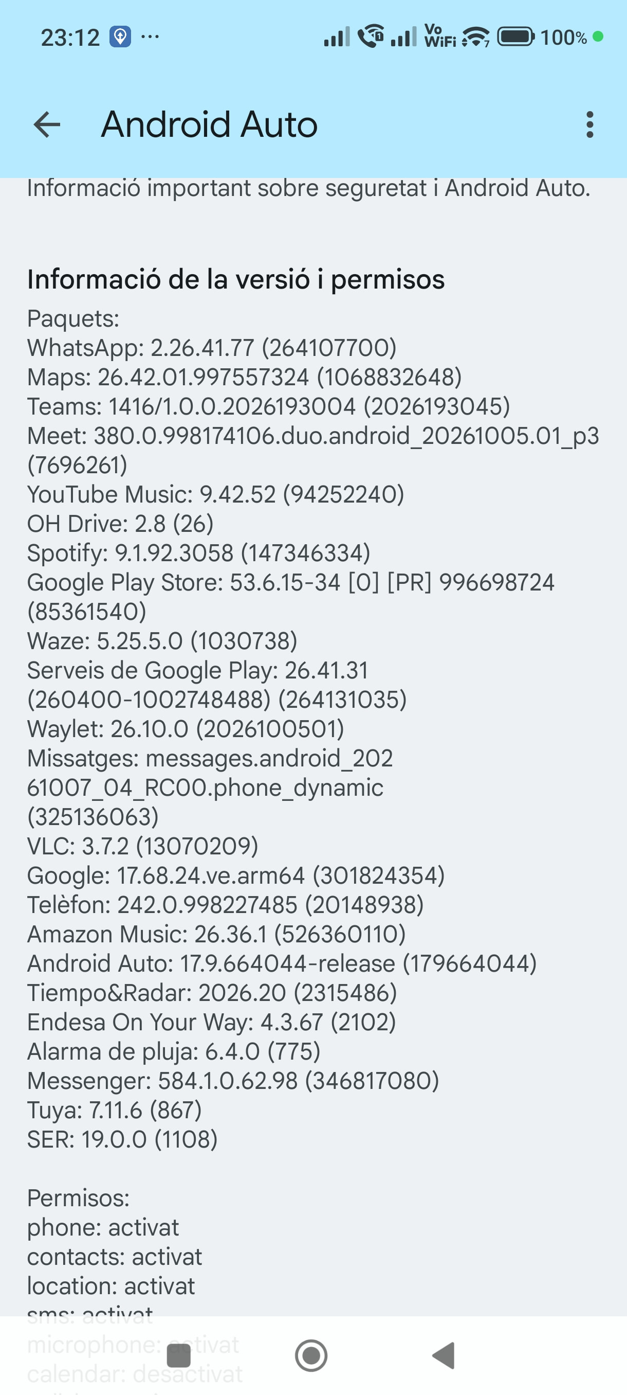

Last check: I have checked the option of “Allow unkown sources” in Android Auto. I don’t know that that option exists! I have to enable “Developer Mode” in Android Auto that is different from “Developer Mode” in the phone.
Reinstalled version 2.8, and now, surpringnsly, the app allows me to change language and save it, so now is in english.
But actlually the App still doesn’t appear on Android Auto “apps to show”. I have rebooted the phone, but still doesn’t show in that list (second snapshow before). Tomorrow test with the car itself.
Ruben
PD: Edited: Tested on the car and also doesn’t appear :frowning:
Edit 2; very strange, now app appears at Android Auto version info that in theory displays all AA enabled apps… But still refuses to show it. Attach screenshot.
