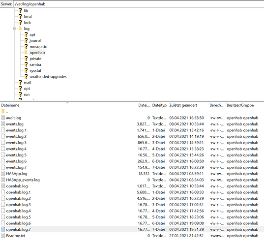

I’m not sure what exactly you mean, but:
  • the rights seem to be ok (openhab/openhab - see screenshot below)
  • the errors in the log file are similar to the ones in my posting above, e.g.:
