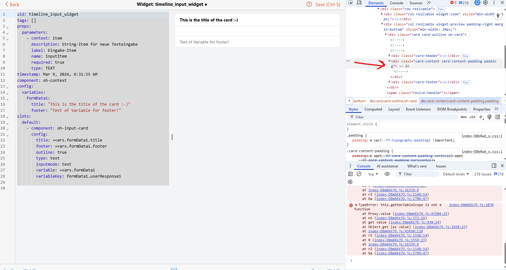

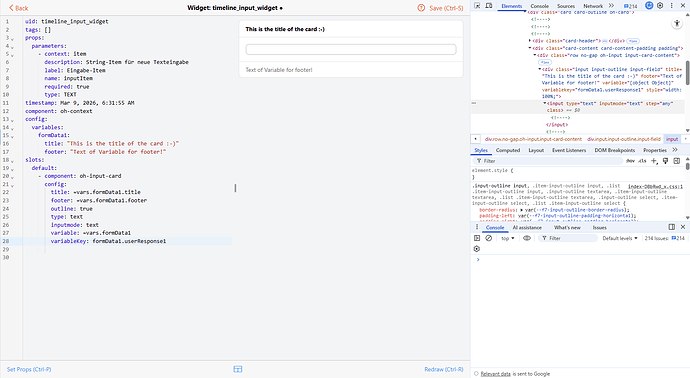

Initial case:
What I achieved so far: I can create the widget and initiate some variables with values. When I display these variables in my widget, the corresponding values will be shown. (See screenshot Heading and Footer of oh-input-card)
Weird case:
And now comes the weird thing for me: As long as I change some YAML code, the widget is rendered like in the screenshot above. As soon as I click “Redraw”, the input field disapears and I get an error message in my console as well as the HTML element for the input field disappears. See screenshot below:
The error message in the console:
index-D8m6Kk7Q.js:1070 TypeError: this.getVariableScope is not a function
    at Proxy.value (index-D8m6Kk7Q.js:43504:25)
    at nt (index-D8m6Kk7Q.js:372:19)
    at get value (index-D8m6Kk7Q.js:930:14)
    at Object.get [as value] (index-D8m6Kk7Q.js:1658:23)
    at index-D8m6Kk7Q.js:43650:110
    at r2 (index-D8m6Kk7Q.js:1148:14)
    at R (index-D8m6Kk7Q.js:1559:23)
    at index-D8m6Kk7Q.js:16339:9
    at Ga (index-D8m6Kk7Q.js:2708:47)
