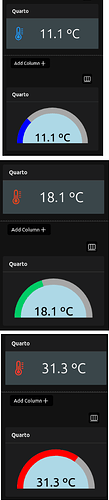

I’m running OH 4.3.2 and have the same expression on oh-label-card as well as on oh-gauge-card
On oh-gauge-card I can see three differente colors for 3 different values I set for temperature.
On oh-label-card, there are only two colors representing 3 different values.
The expressions are:

The iconColor property in the label card gets sent to the oh-icon component which renders the card’s icon. How that component handles the color depends on the type of icon you are using. That looks like the f7 thermometer icon on the label card, so the oh-icon uses the f7 icon color system. F7 doesn’t accept arbitrary colors, it only accepts colors from a limited list of color name strings in the library:
If you just change the #00cc66 in your expression to green you’ll see three colors instead of two. The f7 green, however is #4cd964, so it will be a little different than the one you are using for the gauge, if that matters to you.
