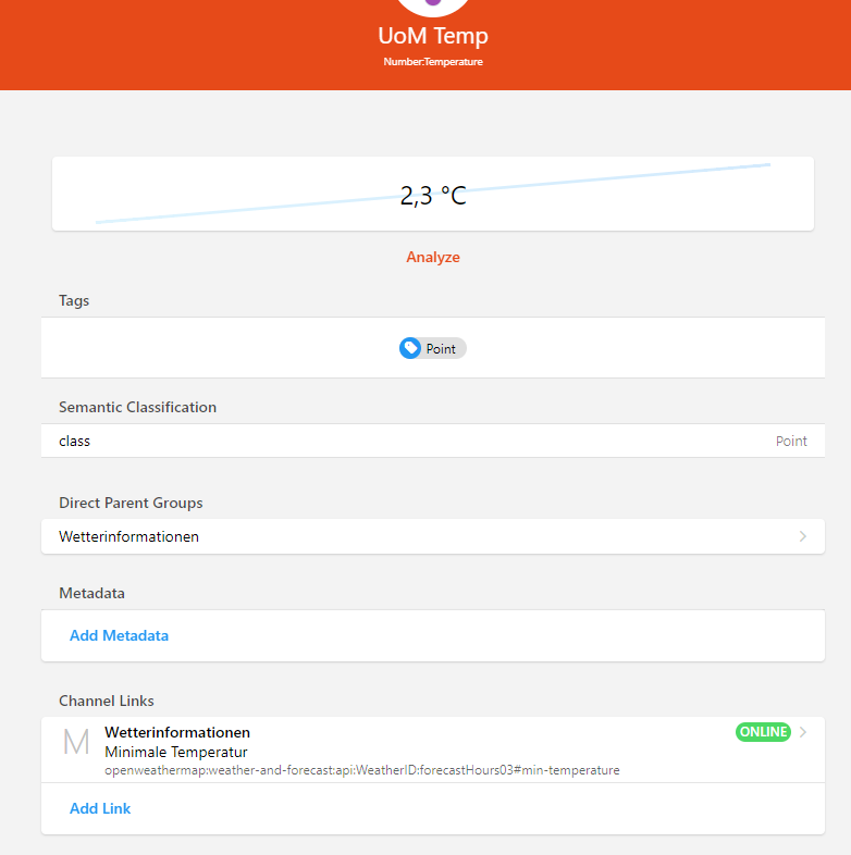

Number:Temperature     Informations_uom_number     "UoM Temp"     <Temperature>     (Wetterinformationen)     ["Point"]     { channel="openweathermap:weather-and-forecast:api:WeatherID:forecastHours03#min-temperature" }
which looks like this in the UI:
As said above, this is what I get, when I execute the following expression in the dev-tools =items.Informations_uom_number:
{ "state": "2.31 °C", "displayState": "2,3 °C" }
If I try to compare the state value like this then, I get the expected true/false informations =items.Informations_uom_number.state < "3" (true)
=items.Informations_uom_number.state > "3" (false)
Do you see any differences in the settings, which could lead to the seen behaviour?
