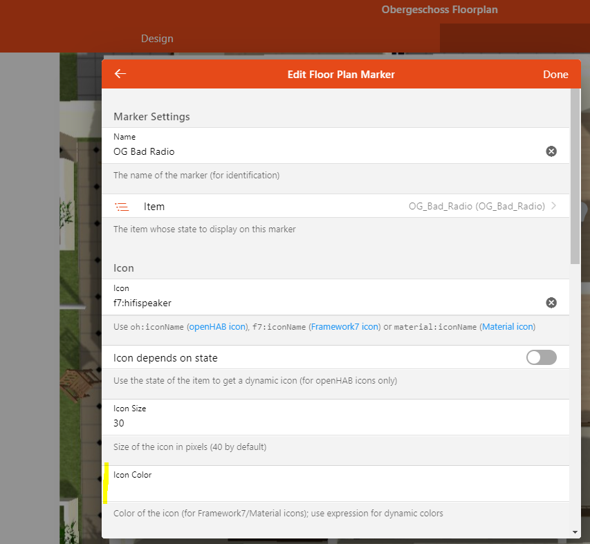

Has someone an Idea what syntax is neccecary to change the colour of my F7 icon?
→ I have tried and read many things, but nothing really works…
→ When the colour change works, then I would try to change the Icon by the state of my Item if possible.
component: oh-plan-marker
  coords: 220.7853332824764,460.86258889060605
  name: OG Bad Radio
  icon: f7:hifispeaker
  iconUseState: false
  item: OG_Bad_Radio
  action: toggle
  actionItem: OG_Bad_Radio
  actionCommandAlt: OFF
  actionCommand: ON
  iconSize: 30
  iconColor:
    ? (OG_Bad_Radio.state) == ON) ? "red"
    ? (OG_Bad_Radio.state) == OFF) ? "green"
slots:
  default: []

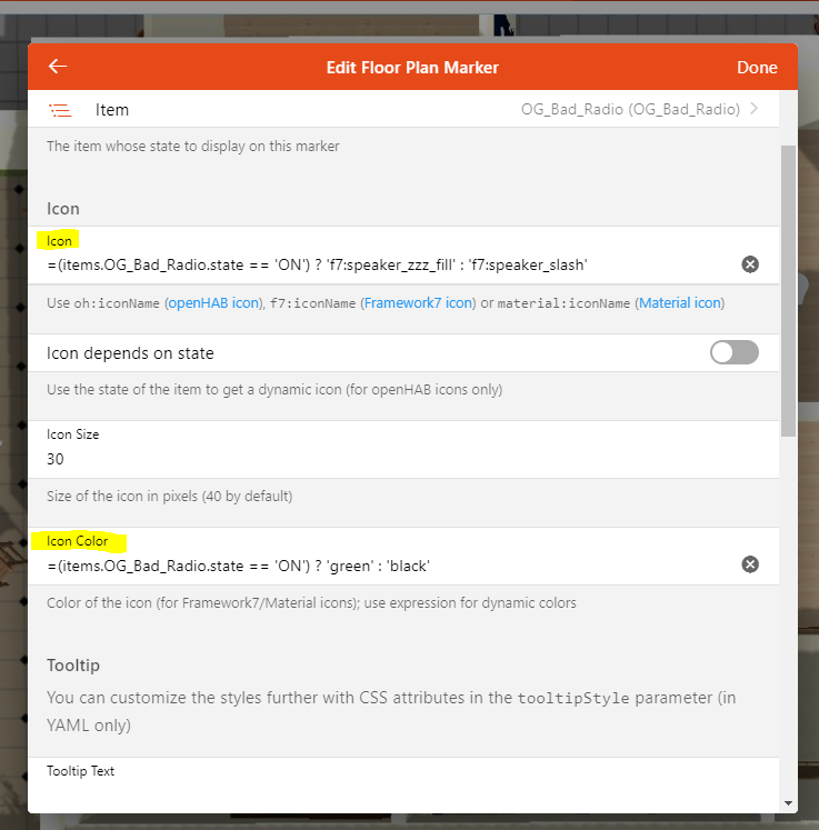

Thank you for explaining me this syntax in understandable words…
→ Now it works well.
And I’m also able to change the icon, if the state is changed.
