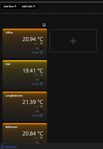

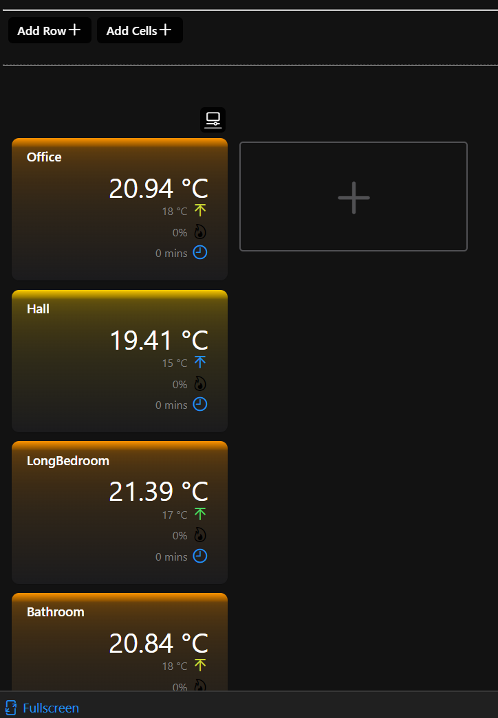

Oh-repeater for oh-grid-cells

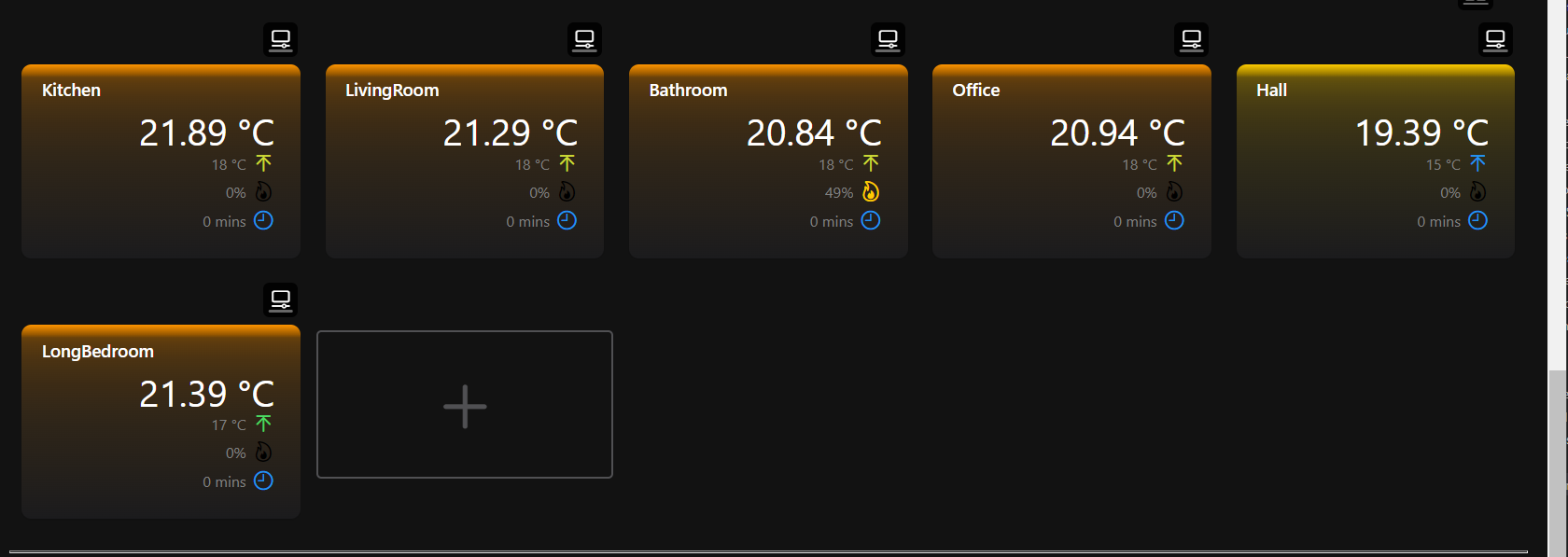

When I create individual cells in the UI, they go horizontally
But if I use an oh-repeater it always goes vertically
Does anyone know how to get around this?

fragment doesn’t seem to help. The repeats still go vertically
component: oh-block
config: {}
  default:
    - component: oh-grid-cells
      config: {}
        default:
          - component: oh-repeater
              for: rad
              sourceType: itemsWithTags
              itemTags: RadiatorControl
              fragment: true
              default:
                - component: widget:RadiatorCell
                    radiator: =loop.rad.name

I have a slightly similar situation (but with standard cards, not cells) where I want them to dynamically be generated on a page with a repeater. My solution to this was simply to build an entire widget that gives me complete control over the alignment and display of the cards and then add that widget to its own whole row on a page.
