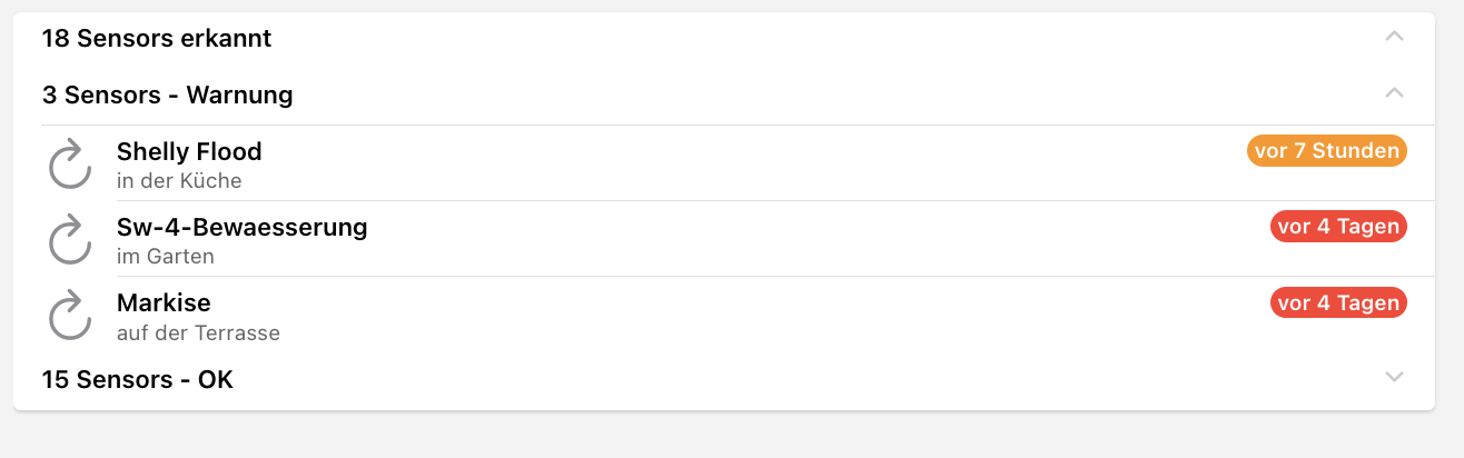

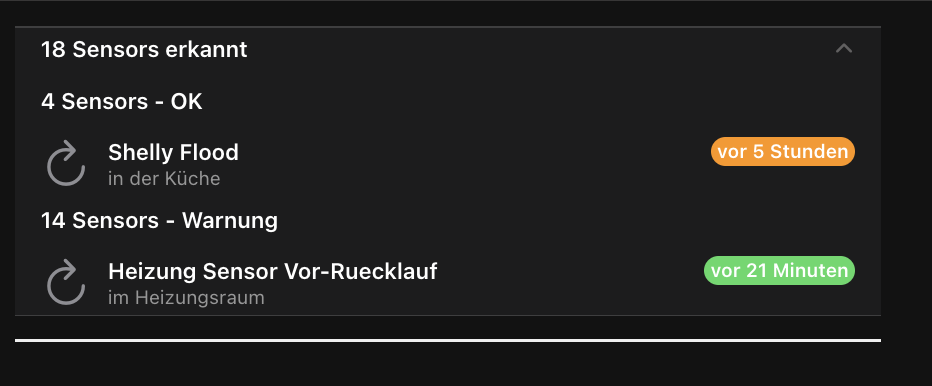

I’m stuck with a oh-repeater issue using oh-list with accordion set to true.
It took some time for me to get accordion working in general. However now the items are not looped anymore, and I don’t know what went wrong

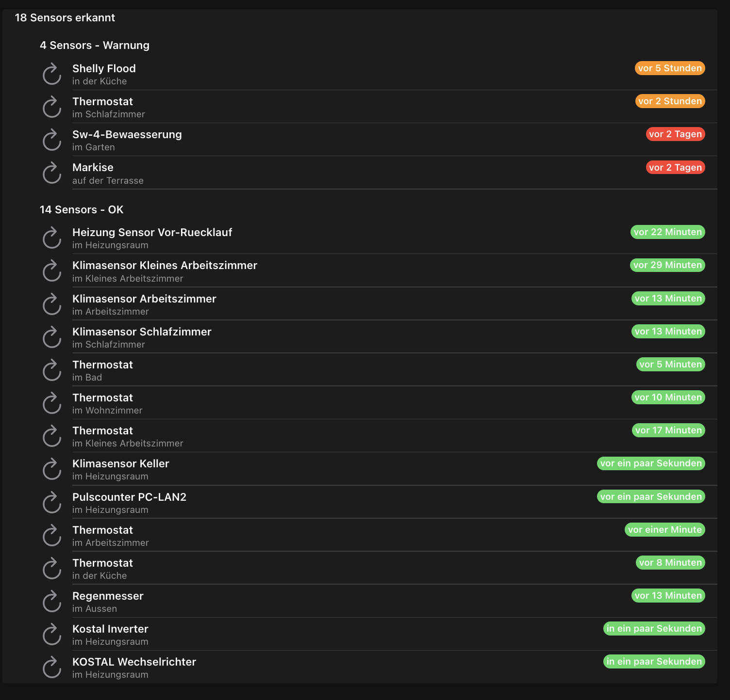

The output should look like below screenshot, but for some reason only 1 item is listed when I use the config with accordion.
Any hint want I did wrong is appreciated
