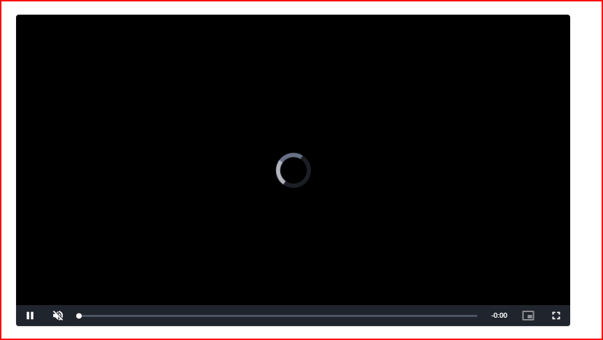

The problem is that the Birdeye stream from frigate is not displayed in the MainUI. It loads and loads and at some point the message is displayed. “The media could not be loaded, either because the server or network failed or because the format is not supported.” I had already tried the other formats in the frigsteServer Thing. Since the stream works with the direct URL call from frigate, I suspect that it is due to ffmpeg or the oh vm.

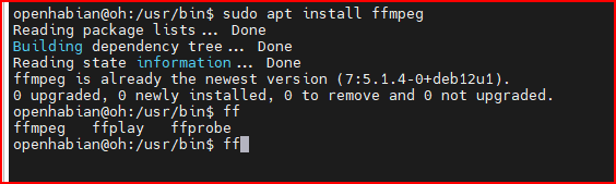

ffmpeg is installed on the OH VM.

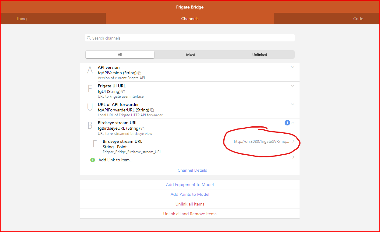

* If the stream is available, the channel 'fgBirdseyeURL' should contain a URL to point a UI widget at to display the Frigate birdseye view.

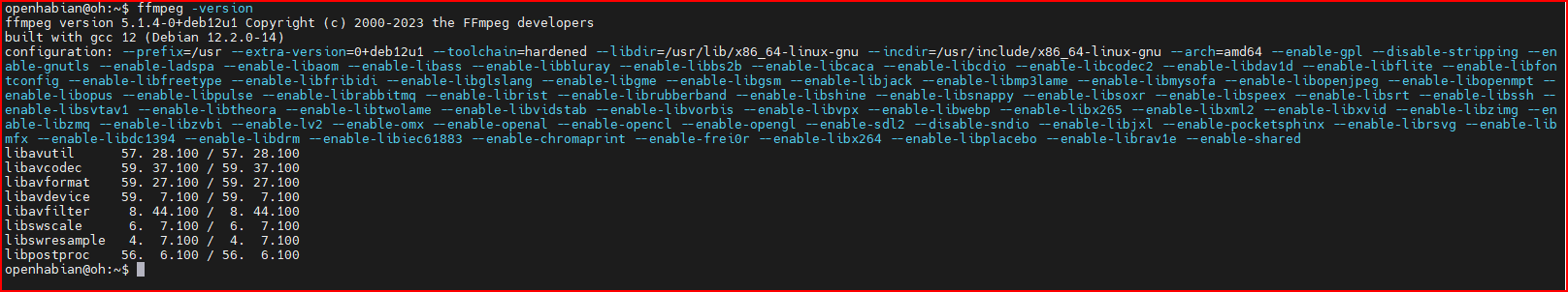

If you can see the rtsp stream directly from vfrigate, then the two places where there may be an issue are firstly with ffmpeg (do you have a recent version?), and then possibly the viewer and/or its interaction with the http server. I see this problem sometimes when viewing with some web browsers; it is currently working here on Firefox.

I can open all streams from Frigate, I can also open the restream URL that OH Frigate Binding generates.
http://oh:8080/frigateSVR/mqtt:frigateServer:mqttbroker:FrigateBridge/birdseye

When I check the MainUI page I see this section.
Yes, it says, “Sorry, your browser does not support embedded videos.”, but no, as I said, everything works in the same browser when the URL is called up directly
<div class="oh-video-card card-content"><div class="player"><div id="vjs_video_3" class="video-js vjs-fluid vjs-paused vjs_video_3-dimensions vjs-workinghover vjs-v7 vjs-user-active vjs-error vjs-controls-disabled" tabindex="-1" role="region" lang="en-de" aria-label="Video Player"><video class="vjs-tech" id="vjs_video_3_html5_api" tabindex="-1" role="application">
Sorry, your browser doesn't support embedded videos.
</video><div class="vjs-poster vjs-hidden" tabindex="-1" aria-disabled="false"></div><div class="vjs-text-track-display" aria-live="off" aria-atomic="true"><div style="position: absolute; inset: 0px; margin: 1.5%;"></div></div><div class="vjs-loading-spinner" dir="ltr"><span class="vjs-control-text">Video Player is loading.</span></div><button class="vjs-big-play-button" type="button" title="Play Video" aria-disabled="false"><span aria-hidden="true" class="vjs-icon-placeholder"></span><span class="vjs-control-text" aria-live="polite">Play Video</span></button><div class="vjs-control-bar" dir="ltr"><button class="vjs-play-control vjs-control vjs-button" type="button" title="Play" aria-disabled="false"><span aria-hidden="true" class="vjs-icon-placeholder"></span><span class="vjs-control-text" aria-live="polite">Play</span></button><div class="vjs-volume-panel vjs-control vjs-volume-panel-horizontal"><button class="vjs-mute-control vjs-control vjs-button" type="button" title="Mute" aria-disabled="false"><span aria-hidden="true" class="vjs-icon-placeholder"></span><span class="vjs-control-text" aria-live="polite">Mute</span></button><div class="vjs-volume-control vjs-control vjs-volume-horizontal"><div tabindex="0" class="vjs-volume-bar vjs-slider-bar vjs-slider vjs-slider-horizontal" role="slider" aria-valuenow="100" aria-valuemin="0" aria-valuemax="100" aria-label="Volume Level" aria-live="polite" aria-valuetext="100%"><div class="vjs-mouse-display"><div class="vjs-volume-tooltip" aria-hidden="true"></div></div><div class="vjs-volume-level"><span class="vjs-control-text"></span></div></div></div></div><div class="vjs-current-time vjs-time-control vjs-control"><span class="vjs-control-text" role="presentation">Current Time </span><span class="vjs-current-time-display" aria-live="off" role="presentation">0:00</span></div><div class="vjs-time-control vjs-time-divider" aria-hidden="true"><div><span>/</span></div></div><div class="vjs-duration vjs-time-control vjs-control"><span class="vjs-control-text" role="presentation">Duration </span><span class="vjs-duration-display" aria-live="off" role="presentation">0:00</span></div><div class="vjs-progress-control vjs-control"><div tabindex="0" class="vjs-progress-holder vjs-slider vjs-slider-horizontal" role="slider" aria-valuenow="0.00" aria-valuemin="0" aria-valuemax="100" aria-label="Progress Bar" aria-valuetext="0:00 of -:-"><div class="vjs-load-progress"><span class="vjs-control-text"><span>Loaded</span>: <span class="vjs-control-text-loaded-percentage">0%</span></span></div><div class="vjs-mouse-display"><div class="vjs-time-tooltip" aria-hidden="true"></div></div><div class="vjs-play-progress vjs-slider-bar" aria-hidden="true" style="width: 0%;"><div class="vjs-time-tooltip" aria-hidden="true" style="right: 0px;">0:00</div></div></div></div><div class="vjs-live-control vjs-control vjs-hidden"><div class="vjs-live-display" aria-live="off"><span class="vjs-control-text">Stream Type </span>LIVE</div></div><button class="vjs-seek-to-live-control vjs-control" type="button" title="Seek to live, currently behind live" aria-disabled="false"><span aria-hidden="true" class="vjs-icon-placeholder"></span><span class="vjs-control-text" aria-live="polite">Seek to live, currently behind live</span><span class="vjs-seek-to-live-text" aria-hidden="true">LIVE</span></button><div class="vjs-remaining-time vjs-time-control vjs-control"><span class="vjs-control-text" role="presentation">Remaining Time </span><span aria-hidden="true">-</span><span class="vjs-remaining-time-display" aria-live="off" role="presentation">0:00</span></div><div class="vjs-custom-control-spacer vjs-spacer "> </div><div class="vjs-playback-rate vjs-menu-button vjs-menu-button-popup vjs-control vjs-button vjs-hidden"><div class="vjs-playback-rate-value" id="vjs-playback-rate-value-label-vjs_video_3_component_323">1x</div><button class="vjs-playback-rate vjs-menu-button vjs-menu-button-popup vjs-button" type="button" aria-disabled="false" title="Playback Rate" aria-haspopup="true" aria-expanded="false" aria-describedby="vjs-playback-rate-value-label-vjs_video_3_component_323"><span aria-hidden="true" class="vjs-icon-placeholder"></span><span class="vjs-control-text" aria-live="polite">Playback Rate</span></button><div class="vjs-menu"><ul class="vjs-menu-content" role="menu"></ul></div></div><div class="vjs-chapters-button vjs-menu-button vjs-menu-button-popup vjs-control vjs-button vjs-hidden"><button class="vjs-chapters-button vjs-menu-button vjs-menu-button-popup vjs-button" type="button" aria-disabled="false" title="Chapters" aria-haspopup="true" aria-expanded="false"><span aria-hidden="true" class="vjs-icon-placeholder"></span><span class="vjs-control-text" aria-live="polite">Chapters</span></button><div class="vjs-menu"><ul class="vjs-menu-content" role="menu"><li class="vjs-menu-title" tabindex="-1">Chapters</li></ul></div></div><div class="vjs-descriptions-button vjs-menu-button vjs-menu-button-popup vjs-control vjs-button vjs-hidden"><button class="vjs-descriptions-button vjs-menu-button vjs-menu-button-popup vjs-button" type="button" aria-disabled="false" title="Descriptions" aria-haspopup="true" aria-expanded="false"><span aria-hidden="true" class="vjs-icon-placeholder"></span><span class="vjs-control-text" aria-live="polite">Descriptions</span></button><div class="vjs-menu"><ul class="vjs-menu-content" role="menu"><li class="vjs-menu-item vjs-selected" tabindex="-1" role="menuitemradio" aria-disabled="false" aria-checked="true"><span class="vjs-menu-item-text">descriptions off</span><span class="vjs-control-text" aria-live="polite">, selected</span></li></ul></div></div><div class="vjs-subs-caps-button vjs-menu-button vjs-menu-button-popup vjs-control vjs-button vjs-hidden"><button class="vjs-subs-caps-button vjs-menu-button vjs-menu-button-popup vjs-button" type="button" aria-disabled="false" title="Subtitles" aria-haspopup="true" aria-expanded="false"><span aria-hidden="true" class="vjs-icon-placeholder"></span><span class="vjs-control-text" aria-live="polite">Subtitles</span></button><div class="vjs-menu"><ul class="vjs-menu-content" role="menu"><li class="vjs-menu-item vjs-texttrack-settings" tabindex="-1" role="menuitem" aria-disabled="false"><span class="vjs-menu-item-text">subtitles settings</span><span class="vjs-control-text" aria-live="polite">, opens subtitles settings dialog</span></li><li class="vjs-menu-item vjs-selected" tabindex="-1" role="menuitemradio" aria-disabled="false" aria-checked="true"><span class="vjs-menu-item-text">subtitles off</span><span class="vjs-control-text" aria-live="polite">, selected</span></li></ul></div></div><div class="vjs-audio-button vjs-menu-button vjs-menu-button-popup vjs-control vjs-button vjs-hidden"><button class="vjs-audio-button vjs-menu-button vjs-menu-button-popup vjs-button" type="button" aria-disabled="false" title="Audio Track" aria-haspopup="true" aria-expanded="false"><span aria-hidden="true" class="vjs-icon-placeholder"></span><span class="vjs-control-text" aria-live="polite">Audio Track</span></button><div class="vjs-menu"><ul class="vjs-menu-content" role="menu"></ul></div></div><button class="vjs-picture-in-picture-control vjs-control vjs-button vjs-disabled" type="button" title="Picture-in-Picture" aria-disabled="true" disabled="disabled"><span aria-hidden="true" class="vjs-icon-placeholder"></span><span class="vjs-control-text" aria-live="polite">Picture-in-Picture</span></button><button class="vjs-fullscreen-control vjs-control vjs-button" type="button" title="Fullscreen" aria-disabled="false"><span aria-hidden="true" class="vjs-icon-placeholder"></span><span class="vjs-control-text" aria-live="polite">Fullscreen</span></button></div><div class="vjs-error-display vjs-modal-dialog" tabindex="-1" aria-describedby="vjs_video_3_component_540_description" aria-hidden="false" aria-label="Modal Window" role="dialog"><p class="vjs-modal-dialog-description vjs-control-text" id="vjs_video_3_component_540_description">This is a modal window.</p><div class="vjs-modal-dialog-content" role="document">No compatible source was found for this media.</div></div><div class="vjs-modal-dialog vjs-hidden vjs-text-track-settings" tabindex="-1" aria-describedby="vjs_video_3_component_546_description" aria-hidden="true" aria-label="Caption Settings Dialog" role="dialog"><p class="vjs-modal-dialog-description vjs-control-text" id="vjs_video_3_component_546_description">Beginning of dialog window. Escape will cancel and close the window.</p><div class="vjs-modal-dialog-content" role="document"><div class="vjs-track-settings-colors"><fieldset class="vjs-fg-color vjs-track-setting"><legend id="captions-text-legend-vjs_video_3_component_546">Text</legend><label id="captions-foreground-color-vjs_video_3_component_546" class="vjs-label">Color</label><select aria-labelledby="captions-text-legend-vjs_video_3_component_546 captions-foreground-color-vjs_video_3_component_546"><option id="captions-foreground-color-vjs_video_3_component_546-White" value="#FFF" aria-labelledby="captions-text-legend-vjs_video_3_component_546 captions-foreground-color-vjs_video_3_component_546 captions-foreground-color-vjs_video_3_component_546-White">White</option><option id="captions-foreground-color-vjs_video_3_component_546-Black" value="#000" aria-labelledby="captions-text-legend-vjs_video_3_component_546 captions-foreground-color-vjs_video_3_component_546 captions-foreground-color-vjs_video_3_component_546-Black">Black</option><option id="captions-foreground-color-vjs_video_3_component_546-Red" value="#F00" aria-labelledby="captions-text-legend-vjs_video_3_component_546 captions-foreground-color-vjs_video_3_component_546 captions-foreground-color-vjs_video_3_component_546-Red">Red</option><option id="captions-foreground-color-vjs_video_3_component_546-Green" value="#0F0" aria-labelledby="captions-text-legend-vjs_video_3_component_546 captions-foreground-color-vjs_video_3_component_546 captions-foreground-color-vjs_video_3_component_546-Green">Green</option><option id="captions-foreground-color-vjs_video_3_component_546-Blue" value="#00F" aria-labelledby="captions-text-legend-vjs_video_3_component_546 captions-foreground-color-vjs_video_3_component_546 captions-foreground-color-vjs_video_3_component_546-Blue">Blue</option><option id="captions-foreground-color-vjs_video_3_component_546-Yellow" value="#FF0" aria-labelledby="captions-text-legend-vjs_video_3_component_546 captions-foreground-color-vjs_video_3_component_546 captions-foreground-color-vjs_video_3_component_546-Yellow">Yellow</option><option id="captions-foreground-color-vjs_video_3_component_546-Magenta" value="#F0F" aria-labelledby="captions-text-legend-vjs_video_3_component_546 captions-foreground-color-vjs_video_3_component_546 captions-foreground-color-vjs_video_3_component_546-Magenta">Magenta</option><option id="captions-foreground-color-vjs_video_3_component_546-Cyan" value="#0FF" aria-labelledby="captions-text-legend-vjs_video_3_component_546 captions-foreground-color-vjs_video_3_component_546 captions-foreground-color-vjs_video_3_component_546-Cyan">Cyan</option></select><span class="vjs-text-opacity vjs-opacity"><label id="captions-foreground-opacity-vjs_video_3_component_546" class="vjs-label">Transparency</label><select aria-labelledby="captions-text-legend-vjs_video_3_component_546 captions-foreground-opacity-vjs_video_3_component_546"><option id="captions-foreground-opacity-vjs_video_3_component_546-Opaque" value="1" aria-labelledby="captions-text-legend-vjs_video_3_component_546 captions-foreground-opacity-vjs_video_3_component_546 captions-foreground-opacity-vjs_video_3_component_546-Opaque">Opaque</option><option id="captions-foreground-opacity-vjs_video_3_component_546-SemiTransparent" value="0.5" aria-labelledby="captions-text-legend-vjs_video_3_component_546 captions-foreground-opacity-vjs_video_3_component_546 captions-foreground-opacity-vjs_video_3_component_546-SemiTransparent">Semi-Transparent</option></select></span></fieldset><fieldset class="vjs-bg-color vjs-track-setting"><legend id="captions-background-vjs_video_3_component_546">Background</legend><label id="captions-background-color-vjs_video_3_component_546" class="vjs-label">Color</label><select aria-labelledby="captions-background-vjs_video_3_component_546 captions-background-color-vjs_video_3_component_546"><option id="captions-background-color-vjs_video_3_component_546-Black" value="#000" aria-labelledby="captions-background-vjs_video_3_component_546 captions-background-color-vjs_video_3_component_546 captions-background-color-vjs_video_3_component_546-Black">Black</option><option id="captions-background-color-vjs_video_3_component_546-White" value="#FFF" aria-labelledby="captions-background-vjs_video_3_component_546 captions-background-color-vjs_video_3_component_546 captions-background-color-vjs_video_3_component_546-White">White</option><option id="captions-background-color-vjs_video_3_component_546-Red" value="#F00" aria-labelledby="captions-background-vjs_video_3_component_546 captions-background-color-vjs_video_3_component_546 captions-background-color-vjs_video_3_component_546-Red">Red</option><option id="captions-background-color-vjs_video_3_component_546-Green" value="#0F0" aria-labelledby="captions-background-vjs_video_3_component_546 captions-background-color-vjs_video_3_component_546 captions-background-color-vjs_video_3_component_546-Green">Green</option><option id="captions-background-color-vjs_video_3_component_546-Blue" value="#00F" aria-labelledby="captions-background-vjs_video_3_component_546 captions-background-color-vjs_video_3_component_546 captions-background-color-vjs_video_3_component_546-Blue">Blue</option><option id="captions-background-color-vjs_video_3_component_546-Yellow" value="#FF0" aria-labelledby="captions-background-vjs_video_3_component_546 captions-background-color-vjs_video_3_component_546 captions-background-color-vjs_video_3_component_546-Yellow">Yellow</option><option id="captions-background-color-vjs_video_3_component_546-Magenta" value="#F0F" aria-labelledby="captions-background-vjs_video_3_component_546 captions-background-color-vjs_video_3_component_546 captions-background-color-vjs_video_3_component_546-Magenta">Magenta</option><option id="captions-background-color-vjs_video_3_component_546-Cyan" value="#0FF" aria-labelledby="captions-background-vjs_video_3_component_546 captions-background-color-vjs_video_3_component_546 captions-background-color-vjs_video_3_component_546-Cyan">Cyan</option></select><span class="vjs-bg-opacity vjs-opacity"><label id="captions-background-opacity-vjs_video_3_component_546" class="vjs-label">Transparency</label><select aria-labelledby="captions-background-vjs_video_3_component_546 captions-background-opacity-vjs_video_3_component_546"><option id="captions-background-opacity-vjs_video_3_component_546-Opaque" value="1" aria-labelledby="captions-background-vjs_video_3_component_546 captions-background-opacity-vjs_video_3_component_546 captions-background-opacity-vjs_video_3_component_546-Opaque">Opaque</option><option id="captions-background-opacity-vjs_video_3_component_546-SemiTransparent" value="0.5" aria-labelledby="captions-background-vjs_video_3_component_546 captions-background-opacity-vjs_video_3_component_546 captions-background-opacity-vjs_video_3_component_546-SemiTransparent">Semi-Transparent</option><option id="captions-background-opacity-vjs_video_3_component_546-Transparent" value="0" aria-labelledby="captions-background-vjs_video_3_component_546 captions-background-opacity-vjs_video_3_component_546 captions-background-opacity-vjs_video_3_component_546-Transparent">Transparent</option></select></span></fieldset><fieldset class="vjs-window-color vjs-track-setting"><legend id="captions-window-vjs_video_3_component_546">Window</legend><label id="captions-window-color-vjs_video_3_component_546" class="vjs-label">Color</label><select aria-labelledby="captions-window-vjs_video_3_component_546 captions-window-color-vjs_video_3_component_546"><option id="captions-window-color-vjs_video_3_component_546-Black" value="#000" aria-labelledby="captions-window-vjs_video_3_component_546 captions-window-color-vjs_video_3_component_546 captions-window-color-vjs_video_3_component_546-Black">Black</option><option id="captions-window-color-vjs_video_3_component_546-White" value="#FFF" aria-labelledby="captions-window-vjs_video_3_component_546 captions-window-color-vjs_video_3_component_546 captions-window-color-vjs_video_3_component_546-White">White</option><option id="captions-window-color-vjs_video_3_component_546-Red" value="#F00" aria-labelledby="captions-window-vjs_video_3_component_546 captions-window-color-vjs_video_3_component_546 captions-window-color-vjs_video_3_component_546-Red">Red</option><option id="captions-window-color-vjs_video_3_component_546-Green" value="#0F0" aria-labelledby="captions-window-vjs_video_3_component_546 captions-window-color-vjs_video_3_component_546 captions-window-color-vjs_video_3_component_546-Green">Green</option><option id="captions-window-color-vjs_video_3_component_546-Blue" value="#00F" aria-labelledby="captions-window-vjs_video_3_component_546 captions-window-color-vjs_video_3_component_546 captions-window-color-vjs_video_3_component_546-Blue">Blue</option><option id="captions-window-color-vjs_video_3_component_546-Yellow" value="#FF0" aria-labelledby="captions-window-vjs_video_3_component_546 captions-window-color-vjs_video_3_component_546 captions-window-color-vjs_video_3_component_546-Yellow">Yellow</option><option id="captions-window-color-vjs_video_3_component_546-Magenta" value="#F0F" aria-labelledby="captions-window-vjs_video_3_component_546 captions-window-color-vjs_video_3_component_546 captions-window-color-vjs_video_3_component_546-Magenta">Magenta</option><option id="captions-window-color-vjs_video_3_component_546-Cyan" value="#0FF" aria-labelledby="captions-window-vjs_video_3_component_546 captions-window-color-vjs_video_3_component_546 captions-window-color-vjs_video_3_component_546-Cyan">Cyan</option></select><span class="vjs-window-opacity vjs-opacity"><label id="captions-window-opacity-vjs_video_3_component_546" class="vjs-label">Transparency</label><select aria-labelledby="captions-window-vjs_video_3_component_546 captions-window-opacity-vjs_video_3_component_546"><option id="captions-window-opacity-vjs_video_3_component_546-Transparent" value="0" aria-labelledby="captions-window-vjs_video_3_component_546 captions-window-opacity-vjs_video_3_component_546 captions-window-opacity-vjs_video_3_component_546-Transparent">Transparent</option><option id="captions-window-opacity-vjs_video_3_component_546-SemiTransparent" value="0.5" aria-labelledby="captions-window-vjs_video_3_component_546 captions-window-opacity-vjs_video_3_component_546 captions-window-opacity-vjs_video_3_component_546-SemiTransparent">Semi-Transparent</option><option id="captions-window-opacity-vjs_video_3_component_546-Opaque" value="1" aria-labelledby="captions-window-vjs_video_3_component_546 captions-window-opacity-vjs_video_3_component_546 captions-window-opacity-vjs_video_3_component_546-Opaque">Opaque</option></select></span></fieldset></div><div class="vjs-track-settings-font"><fieldset class="vjs-font-percent vjs-track-setting"><legend id="captions-font-size-vjs_video_3_component_546" class="">Font Size</legend><select aria-labelledby="captions-font-size-vjs_video_3_component_546"><option id="captions-font-size-vjs_video_3_component_546-50" value="0.50" aria-labelledby="captions-font-size-vjs_video_3_component_546 captions-font-size-vjs_video_3_component_546-50">50%</option><option id="captions-font-size-vjs_video_3_component_546-75" value="0.75" aria-labelledby="captions-font-size-vjs_video_3_component_546 captions-font-size-vjs_video_3_component_546-75">75%</option><option id="captions-font-size-vjs_video_3_component_546-100" value="1.00" aria-labelledby="captions-font-size-vjs_video_3_component_546 captions-font-size-vjs_video_3_component_546-100">100%</option><option id="captions-font-size-vjs_video_3_component_546-125" value="1.25" aria-labelledby="captions-font-size-vjs_video_3_component_546 captions-font-size-vjs_video_3_component_546-125">125%</option><option id="captions-font-size-vjs_video_3_component_546-150" value="1.50" aria-labelledby="captions-font-size-vjs_video_3_component_546 captions-font-size-vjs_video_3_component_546-150">150%</option><option id="captions-font-size-vjs_video_3_component_546-175" value="1.75" aria-labelledby="captions-font-size-vjs_video_3_component_546 captions-font-size-vjs_video_3_component_546-175">175%</option><option id="captions-font-size-vjs_video_3_component_546-200" value="2.00" aria-labelledby="captions-font-size-vjs_video_3_component_546 captions-font-size-vjs_video_3_component_546-200">200%</option><option id="captions-font-size-vjs_video_3_component_546-300" value="3.00" aria-labelledby="captions-font-size-vjs_video_3_component_546 captions-font-size-vjs_video_3_component_546-300">300%</option><option id="captions-font-size-vjs_video_3_component_546-400" value="4.00" aria-labelledby="captions-font-size-vjs_video_3_component_546 captions-font-size-vjs_video_3_component_546-400">400%</option></select></fieldset><fieldset class="vjs-edge-style vjs-track-setting"><legend id="vjs_video_3_component_546" class="">Text Edge Style</legend><select aria-labelledby="vjs_video_3_component_546"><option id="vjs_video_3_component_546-None" value="none" aria-labelledby="vjs_video_3_component_546 vjs_video_3_component_546-None">None</option><option id="vjs_video_3_component_546-Raised" value="raised" aria-labelledby="vjs_video_3_component_546 vjs_video_3_component_546-Raised">Raised</option><option id="vjs_video_3_component_546-Depressed" value="depressed" aria-labelledby="vjs_video_3_component_546 vjs_video_3_component_546-Depressed">Depressed</option><option id="vjs_video_3_component_546-Uniform" value="uniform" aria-labelledby="vjs_video_3_component_546 vjs_video_3_component_546-Uniform">Uniform</option><option id="vjs_video_3_component_546-Dropshadow" value="dropshadow" aria-labelledby="vjs_video_3_component_546 vjs_video_3_component_546-Dropshadow">Dropshadow</option></select></fieldset><fieldset class="vjs-font-family vjs-track-setting"><legend id="captions-font-family-vjs_video_3_component_546" class="">Font Family</legend><select aria-labelledby="captions-font-family-vjs_video_3_component_546"><option id="captions-font-family-vjs_video_3_component_546-ProportionalSansSerif" value="proportionalSansSerif" aria-labelledby="captions-font-family-vjs_video_3_component_546 captions-font-family-vjs_video_3_component_546-ProportionalSansSerif">Proportional Sans-Serif</option><option id="captions-font-family-vjs_video_3_component_546-MonospaceSansSerif" value="monospaceSansSerif" aria-labelledby="captions-font-family-vjs_video_3_component_546 captions-font-family-vjs_video_3_component_546-MonospaceSansSerif">Monospace Sans-Serif</option><option id="captions-font-family-vjs_video_3_component_546-ProportionalSerif" value="proportionalSerif" aria-labelledby="captions-font-family-vjs_video_3_component_546 captions-font-family-vjs_video_3_component_546-ProportionalSerif">Proportional Serif</option><option id="captions-font-family-vjs_video_3_component_546-MonospaceSerif" value="monospaceSerif" aria-labelledby="captions-font-family-vjs_video_3_component_546 captions-font-family-vjs_video_3_component_546-MonospaceSerif">Monospace Serif</option><option id="captions-font-family-vjs_video_3_component_546-Casual" value="casual" aria-labelledby="captions-font-family-vjs_video_3_component_546 captions-font-family-vjs_video_3_component_546-Casual">Casual</option><option id="captions-font-family-vjs_video_3_component_546-Script" value="script" aria-labelledby="captions-font-family-vjs_video_3_component_546 captions-font-family-vjs_video_3_component_546-Script">Script</option><option id="captions-font-family-vjs_video_3_component_546-SmallCaps" value="small-caps" aria-labelledby="captions-font-family-vjs_video_3_component_546 captions-font-family-vjs_video_3_component_546-SmallCaps">Small Caps</option></select></fieldset></div><div class="vjs-track-settings-controls"><button type="button" class="vjs-default-button" title="restore all settings to the default values">Reset<span class="vjs-control-text"> restore all settings to the default values</span></button><button type="button" class="vjs-done-button">Done</button></div></div><button class="vjs-close-button vjs-control vjs-button" type="button" aria-disabled="false" title="Close Modal Dialog"><span aria-hidden="true" class="vjs-icon-placeholder"></span><span class="vjs-control-text" aria-live="polite">Close Modal Dialog</span></button><p class="vjs-control-text">End of dialog window.</p></div></div></div></div>

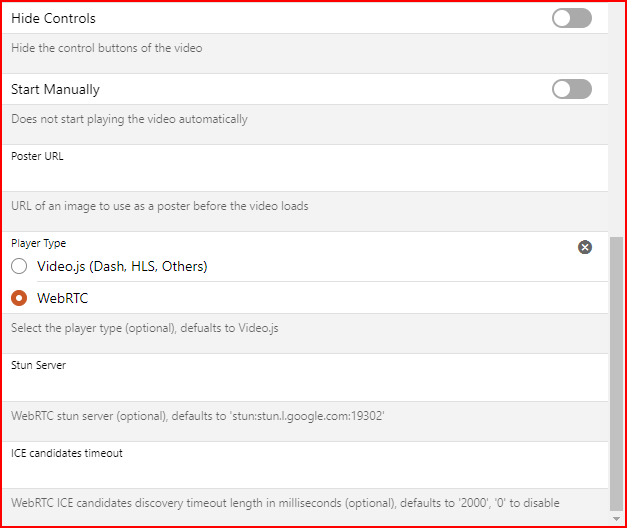

I have also tried another player type (WebRTC), but it doesn’t really make a difference
<div class="oh-video-card card-content"><div class="player"><video autoplay="autoplay" controls="controls" playsinline="" style="max-width: 100%;" class="">
</video></div></div>
