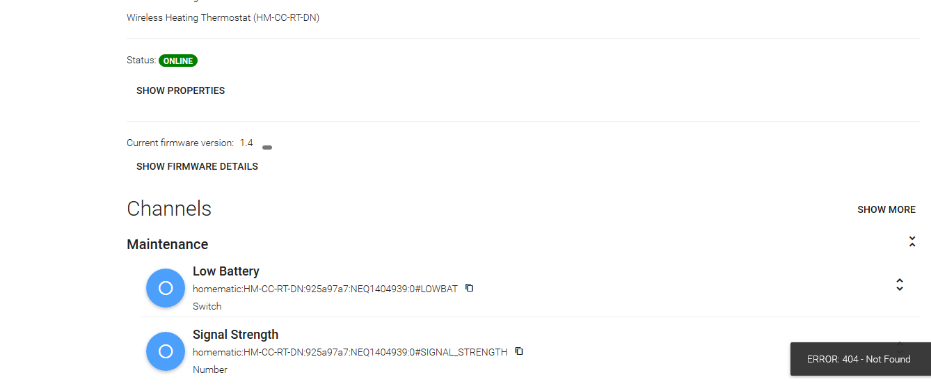

Below is a screenshot of the error message I see in the Paper UI when accessing the Homematic Things:
Thanks for your help and best regards,
Gabriel
If you see immediately the error 404 then maybe you stored configuration is damaged. But this means that openhab.log should already show some error message. Can you check it?

Sorry for the late reply. The 404 error was fixed by an upgrade to OpenHAB
2.2. I have to admit that the other issue (inability to update channels)
was a layer 8 issue - when moving from HomeGear to CCU2 I missed the
changed channel nomenclature.
Thanks for your support and apologies for wasting your time :slight_smile:
