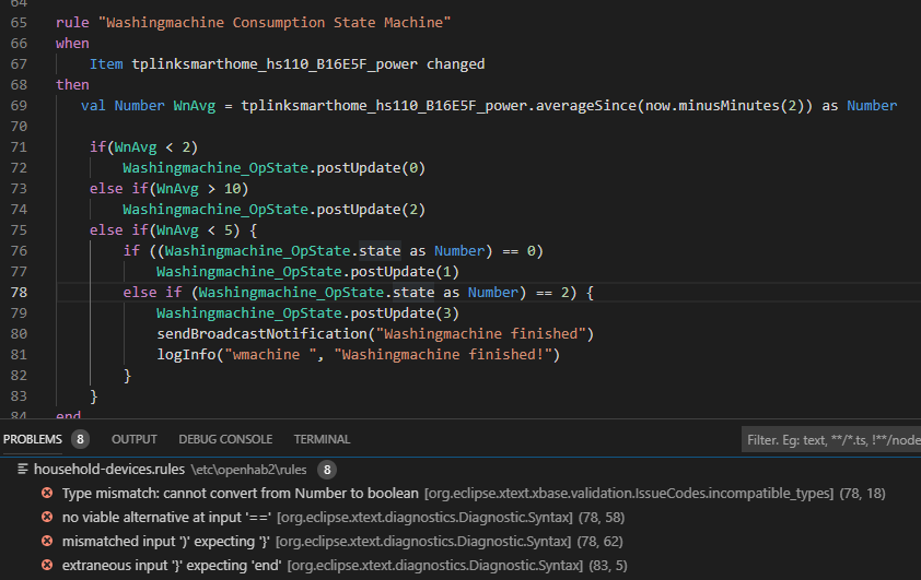

I just restarted the OH service and I got the following errors:???
018-12-12 10:05:39.530 [ERROR] [ntime.internal.engine.RuleEngineImpl] - Rule 'Washingmachine Consumption State Machine': The name 'tplinksmarthome_hs110_B16E5F_power' cannot be resolved to an item or type; line 39, column 24, length 34
2018-12-12 10:05:39.532 [ERROR] [ntime.internal.engine.RuleEngineImpl] - Rule 'Dryer Consumption State Machine': The name 'tplinksmarthome_hs110_B1AFF9_power' cannot be resolved to an item or type; line 124, column 24, length 34
To be honest, I’m a bit confused by the MODE_OFF (and the others) status, as this is no status. Either use a Number (0 Off, 1 Standby, 2 active, 3 finished)or use a String Item. I don’t know if this error will have impact to the trailing line. I would do it like this:
items:
Number Washingmachine_OpState           "Washing Machine State [MAP(wmachine.map):%s]"
wmachine.map
0 = OFF
1 = Standby
2 = Active
3 = finished
NULL = -
rule "Washingmachine Consumption State Machine"
    Item tplinksmarthome_hs110_B16E5F_power changed
    val Number WnAvg = tplinksmarthome_hs110_B16E5F_power.averageSince(now.minusMinutes(2)) as Number

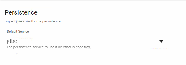

Which persistence service did you use? Is it the default persistence service?
jdbc.persist
And Yes its Default…
And when I tried your suggestion I got the following errors in VSC?
I found the issue
        else if (Washingmachine_OpState.state as Number) == 2) {
Needed an extra “(”
I will test tonight…
        else if ((Washingmachine_OpState.state as Number) == 2) {
Jep. I did a correction above, just for reference…
