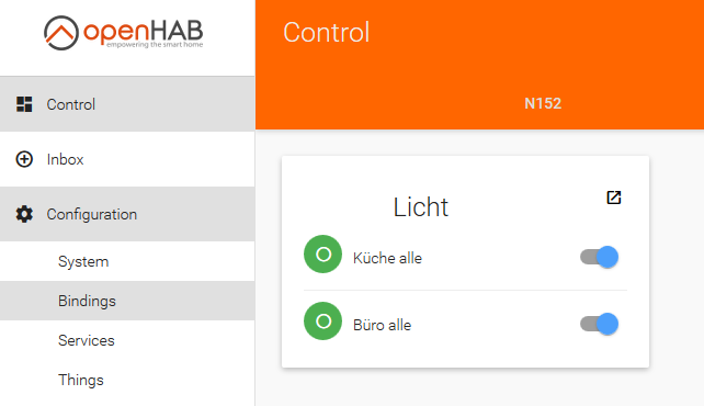

I managed to install openhab 2 with knx 2 binding as described in the topic:
So I am running the 2.3 beta release.
When I Test in the PaperUI at controls the two switches following happens:
  1. The first switching happens at once
  2. The next switching of any device needs about 6 seconds
  3. I I wait 6 seconds or more the next switching happens at once
There is no difference when I use the “<” reading tag. (e.g. “0/0/40+0/0/41” or “0/0/40+<0/0/41”.
Does anybody know what I am doing wrong?
Thany you?
