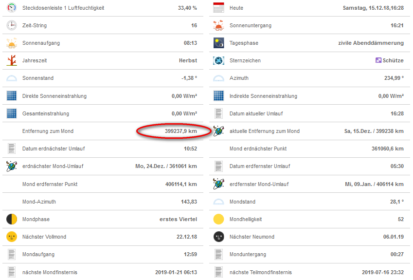

Is there a way to get rid of the Astro binding errors?
2018-12-13 17:50:40.928 [ERROR] [ding.astro.handler.AstroThingHandler] - Can't update state for channel astro:moon:5c6b0ca1:apogee#miles : org.eclipse.smarthome.binding.astro.internal.model.MoonDistance.getMiles()
java.lang.NoSuchMethodException: org.eclipse.smarthome.binding.astro.internal.model.MoonDistance.getMiles()

The miles channel got replaced with a distance channel in 2.4.0 because UoM was introduced. See also the binding documentation.
You may need to delete/readd the respective Things when you donāt see the new channels. Thatās a workaround for eclipse/smarthome#2555.
I did delete/readd the things in the file ⦠no change. I am not sure how it is possible to make it so complex to simply want to know if it is daylight or not in OH. On of the most basic functions for home automation yet in OH it takes hours to figure out this simple event. Frustrating. Not blaming anyone just venting.

Hi,maybe this can help you ?!
.items
//Number Miles_distance "Distance to Moon" (gAstro) {channel="astro:moon:local:distance#miles"}
Number:Length Kilometer_distance "Entfernung zum Mond" (gAstro) {channel="astro:moon:local:distance#distance"} //OH 2.4
An the Rest comes from UoM, like here:
Hope you can use it.
