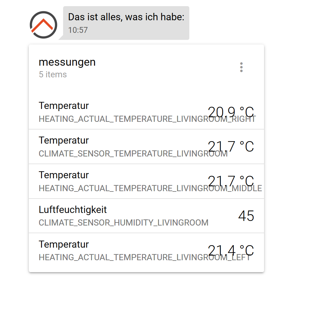

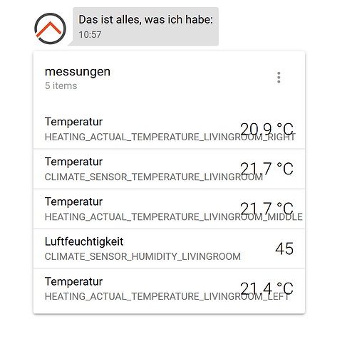

just switched to OH2.4.0-M8 and gave a quick shot to HABot. HABot is quite impressive but the results are most often not very readable. Any chance to improve this for the final release?
On my Android Smartphone the actual numbers aren’t even visible!
The screenshot is taken on a MacBook running Windows 10 and Firefox 63.0.3.
