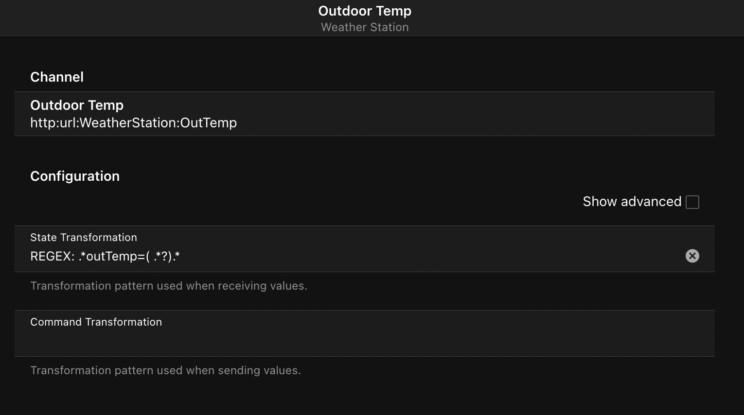

in my Items file. This gave me the outside temp of the weather station. In OH 3 i have added everything via Things UI as follows:
But i am getting UNDEF.
Any pointers appreciated.
Remove the transformation to verify whether the UNDEF is because the binding can’t reach the device or it can’t parse the incoming data.
Nothing changed for REGEX between OH 2.5 and OH 3 so the problem is unlikely to be the transformation.
