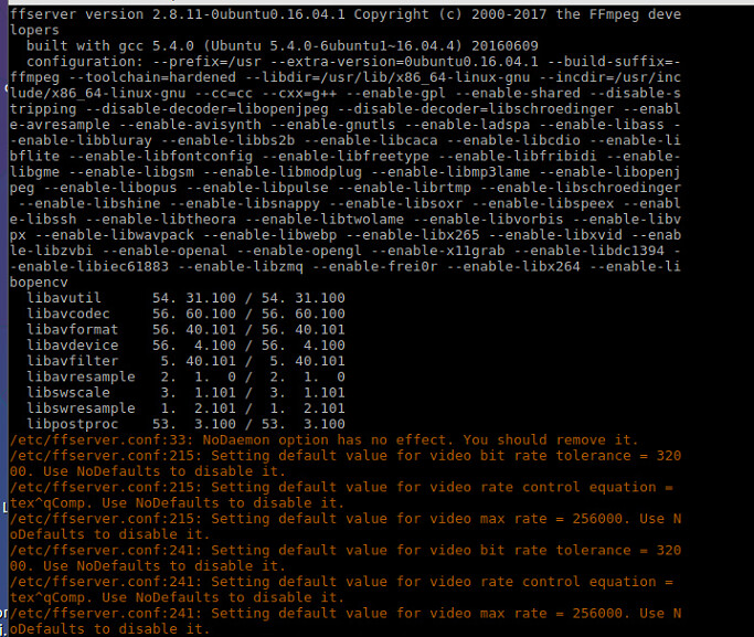

Great so I setup a test box running Ubuntu, I got ffmpeg up and working, and I got my feeds visible within habpanel.
But how do I get ffserver to start at bootup(I’m really sorry, I know its a noob question but I’ve been googleing for hours now)?
And how can I start streams automatically after ffserver starts?
Right now I ssh in and start ffserver manually, then for each camera I open another ssh session and start a stream
