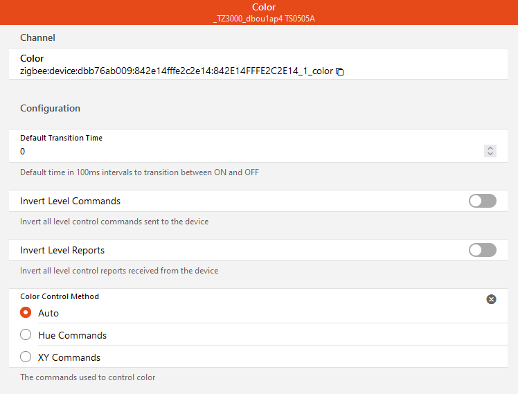

Success (‘XY Commands’ works, ‘Auto’ doesn’t work):
Thanks a lot for your perseverence. :rainbow:
One problem (not sure whether it is problem or whether I’m stretching the openHAB specification …) remains:
The toggle switch (bound to the Group, not to the Color/Dimmer Point) switches the bulb on, but doesn’t switch the bulb off (same problem as with the power strip?).
:slight_smile:
Thanks for testing.
Ok, Ill take another look at this before I think about merging as it might screw with others setups.
This might be the same issue - I need to check what I fixed on the previous update. I might have only updated that for the level and onoff channels, and it might also need doing for the color channel.
We should be clear here - what “doesn’t work”?
By this, do you mean when initialising the device in AUTO, that your device cannot set the color? If so, I would say that AUTO does work since AUTO should work exactly the same as it did in the past (Which for your bulb, didn’t work, and is why we’re making the option to override this).
Is that what you mean? Or does it “not work” in some other way? From my testing here, it should run through the same code as it always did if it is set to AUTO, and detect the commands to use as it did previously.
This will indeed be the same issue as previously. I will take a look at this, but the coior converter needs a little bit more refactoring to implement this so let’s first clear out the Color Control Method issue, get that merged, and then I’ll take a look at resolving the management of commands.
Exactly. It wasn’t clear to me whether ‘AUTO’ tries to work around the misleading information from the bulb or not. If ‘AUTO’ means ‘control the bulb as in the past’, everything is fine. IMHO ‘AUTO’ should be replaced with ‘DEFAULT’ (defined as: HUE, if support for HUE is reported by the device, XY otherwise).
I’ll add this to the description - I think AUTO or DEFAULT provide the same uncertainty so I don’t really see a need to change from AUTO, but I agree maybe adding a description. At the end of the day, if AUTO was guaranteed to work and always select the right option, then we wouldn’t need the override :slight_smile: . I think changing to DEFAULT only really means anything if you’re already using the binding - then yes, this the current default behaviour, and this option is really only required to work around bulbs that don’t work properly so most people should be able to leave it as is.

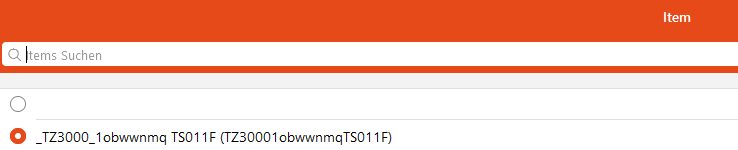

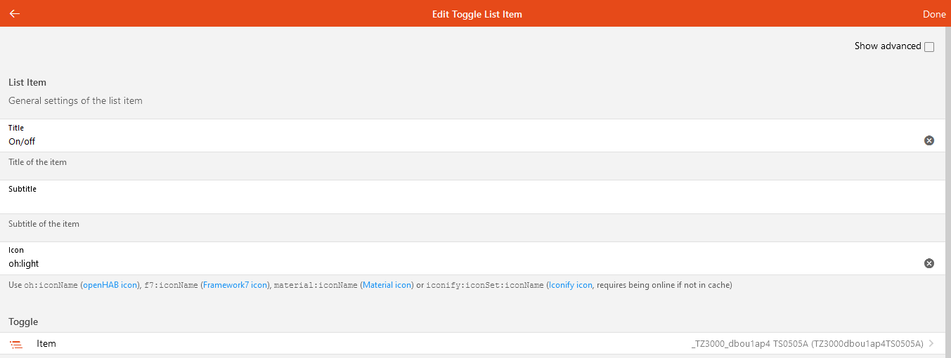

It works from the openhabian console, but it doesn’t work from the UI:
Definition for UI element ‘All on/off’:
UI (edit mode):
‘Toggling All on’ works, ‘toggling All off’ doesn’t work.
When you toggle this, what happens to the toggle - does it stay ON or does it go back to OFF?
I’m assuming that this was caused by the status not being updated - so now it should be updated ok I think.
If you have a log I’m happy to take a look to see if I can spot what is going on.
The UI element behaves as one would expect (clicking toggles the UI element between the two states …), but only the transition off → on changes the state of the physical device.

Thanks.
I think this looks ok from the binding perspective -:
What is interesting is it’s probably not a surprise that this didn’t change with the new binding update since the devices already reported their state. What we see here is the 3 individual commands coming in to the binding (the expansion of the group is done before the binding receives the commands). The binding then sends the 3 commands, and when it receives the DefaulResponse it sets the state to ON (which is the commanded state - this is the new bit I just added).
Immediately after this we also see reports coming in from the device to report its state. This causes a second update of the state for the color bulbs to an HSB of 0,100,100 - this should also be the same as ON since the B part of HSB is 100%.
My guess is that the core, or the UI, then doesn’t allow the OFF command to be sent as something in the system doesn’t like the state. I’m guessing it’s a core problem and it’s not aggregating the group state correctly in this case.
Well, it works from the console (openhab:send ...), but it doesn’t work from the UI. IMHO this points to the UI as the culprit.
Sounds reasonable to me :+1:
