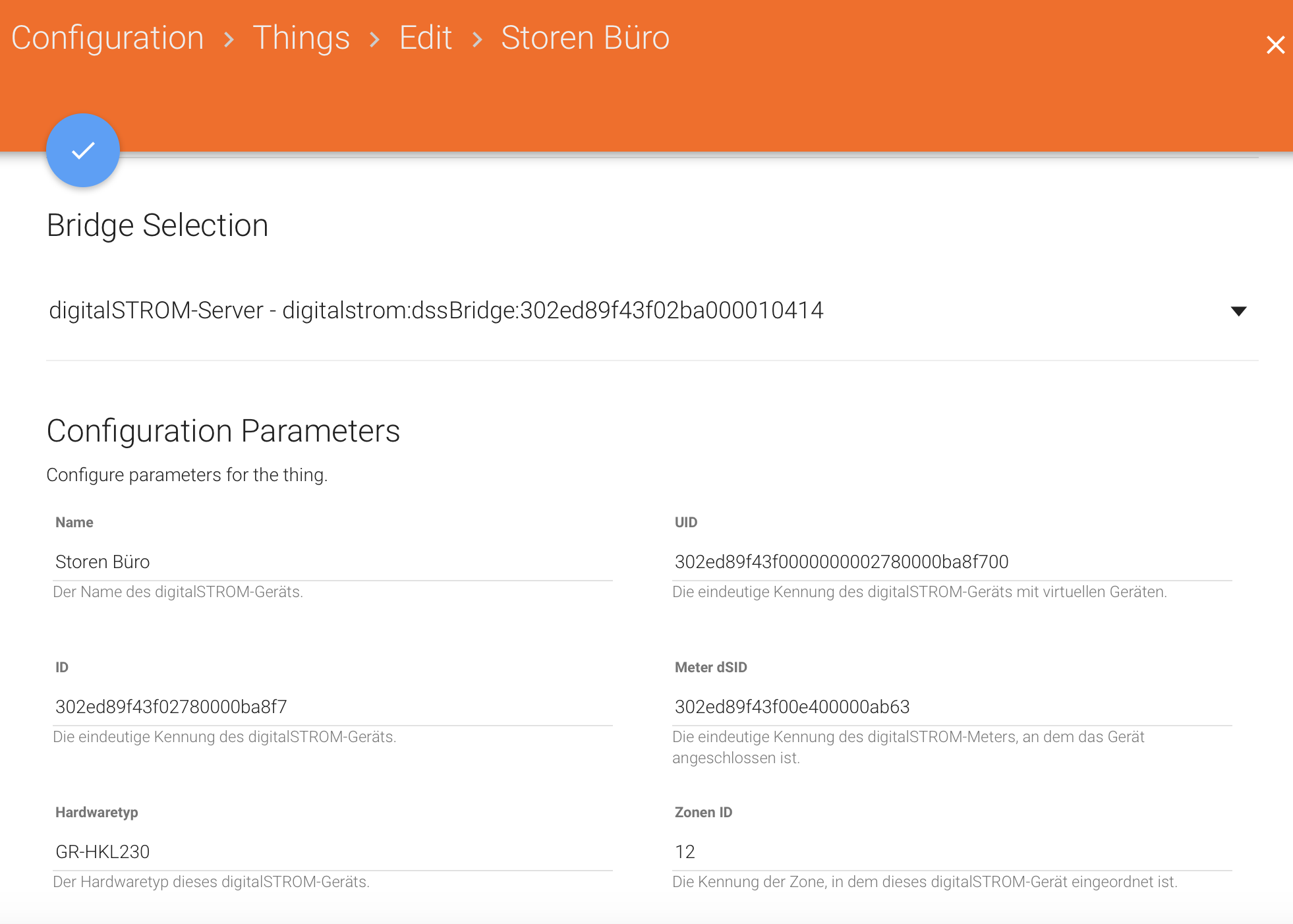

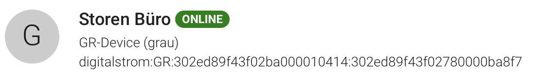

Is it really autodiscovered? If yes, yould you please post a hardcopy of the Thing page.
What you could try is to setup an Item with the appropriate channel definition, as the doc already has a sample for Blinds with angle setting.

I stand corrected! It DID autodetect the proper device, even though it is missing in the documentation.. But, it does not give me the angle, which the device can do..

If your device is autodetected, the binding should read the capabilities and dynamically add the propriate channels. When you look at PaperUI → Config → Things You see these channels, is there a „Show more“ button ?
If not, it seems to be a bug in the Binding, which you should be address at
You don‘t need to define your Things textual, just try to create an Item with the angle channel in your Items file and see if that works.
