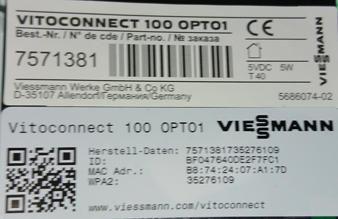

The official Appon Android is running. No Problems.
I have problems to detect the Vitoconnect 100 OPTO1 on OH2
Can’t find the Thing.
I tried to add it manualy but it shows offline. What ist the adapterID (The ID/Name of the adapter)? I tried everything whats on the sticker.
