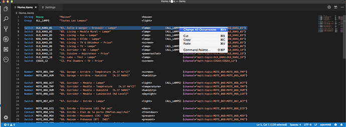

If using Visual Studio Code with the Plugin for openHAB, you can create Items for Chanels by right-click the Channel or even the whole Thing. You have to select an items file first, of course.
Well I am using Eclipse Smart Home designer to edit the files.
I did a trial with Visual Studio Code with the OH plug-in but while editing the items I![01|690x255]! see no way to link the item to a channel

No, don’t do Simple Mode. Instead setup the plugin correctly to use text configuration or (at least) set the items manually via Paper UI. When turning off simple mode, an additional Configuration Chapter Items will appear.
