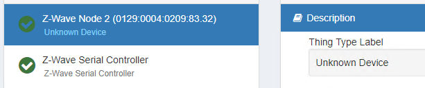

I am trying out the security binding for a Yale YRD210.
I originally just included the lock using the mainstream z-wave binding. There were channels etc that I could access, lock position, battery. But had no access to the secure functionality.
Trying the alpha binding, but have been unsuccessful getting it to work. When I add the lock, it adds it in secure inclusion mode, but detects the lock as an “Unknown Device”. Logs show up as
[warn] wave.discovery.ZWaveDiscoveryService - Node 11: Device discover could not resolve to a thingType! 0129:0004:0209::83.32
I have completely removed/reinstalled OpenHab from mainstream source. Did not install any default bindings. Added the z-wave binding to the Addons folder (and now am trying the Alpha stream in Marketplace). It was suggested that serial was needed, but apparently that is already there as “nrjavaserial”.
So, currently have an issue getting the device to be recognized in the database securely, while having access to the channels available by the lock for battery status, lock status, etc.
I removed the device (not exclude, just remove), but the xml did not get removed, even after service restart. So I moved the xml out of the folder and then tried re-adding, but then the device does not get imported securely. So put the xml back in place, and I can import it securely, but it is an unknown device. Cannot resolve thingType. Most likely Operator error somewhere.
I am running the mainstream Openhab 2.2, not the Snapshot 2.3. I am not sure if Snapshot 2.3 is required? Or is just using the Alpha release of the new z-wave binding sufficient?

This is now in the database and I’ll be doing an update tonight if jetlag doesn’t get me first! :wink: The export is already done - once this is used, it should solve this issue.
No - 2.3 is not required
I’m not sure what you mean by this - you need the dev version of the zwave binding which is currently 2.2 as per the link at the top of this thread.
Thanks Chris.
I was looking at the database at cd-jackson.com, and the device list under Z-Wave Binding information in openHAB, and it was listed there. So I thought I had to be missing some step somewhere…but I now see the “Last Exported On” date on the web database that I had missed.
Looking forward to the update sir!
