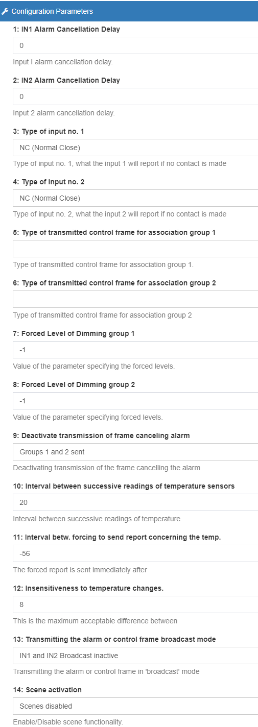

Hi - would you mind sending me a screencap of your configuration parameters and association groups? If it’s working for you it really should be working for me…
When did you update? Running the dev snapshot build I installed yesterday morning, I’m still not seeing them set. (I’ve never actually seen them set, in the last few weeks I’ve been struggling to get the Zwave plugin working – it turns out like 80% of the problems I’ve been having is that associations weren’t working!)
The last update was yesterday afternoon (UK time).
Awesome, I’ll have to find some cycles today to try updating.
If the association issue is fixed, that ought to get me into a usable state with it. (I still haven’t managed to get secure inclusion working, but screwing with it was moot if I couldn’t get anything working.)
the weird thing is, in UI association groups are still showing as empty.
as I mentioned, it started working after I did put in a home-assistant sd card in raspberry, then back the old openhab and it was working.
atm I’m using Dec10 binding. Have downloaded the latest one (1230), but have not had chance to try it. Though, in regards to FGBS, after connecting to has, it was working also with the 1024 version.
(and I have only binary connected, no t sensors; if it changes anything)
