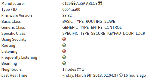

Looking for help troubleshooting security inclusion. Running openHAB 2.3.0~20180307132030-1 (Build #1224) with a aeotec dongle added to OH as a Z-Wave Serial Controller (Z-Wave USB Stick with Serial Interface). I added the network key as a thing parameter when adding the Controller through HABmin . I’m able to add the entry lock (YRD210) I’m trying to control but I can’t control it.

It’s included, but the red X next to Using Security means it was not securely included. Exclude (some locks may need a reset here too) and reinclude through OH from close proximity to the controller.
