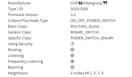

And in the attributes, it have the following look
This is normally caused by a corrupt frame received from the device - or at least a frame that is not what the binding expects. Possibly it’s an invalid Nonce, but that’s just a guess and I’d need to see a debug log showing the received frame to say more.

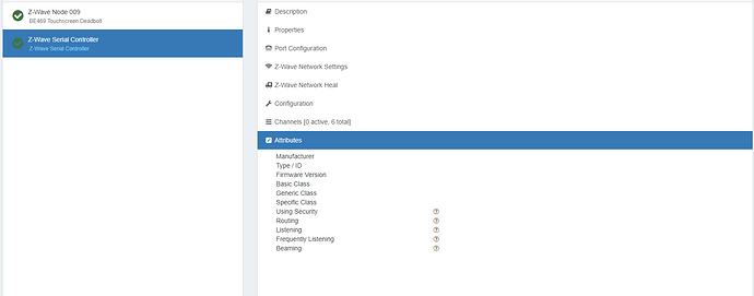

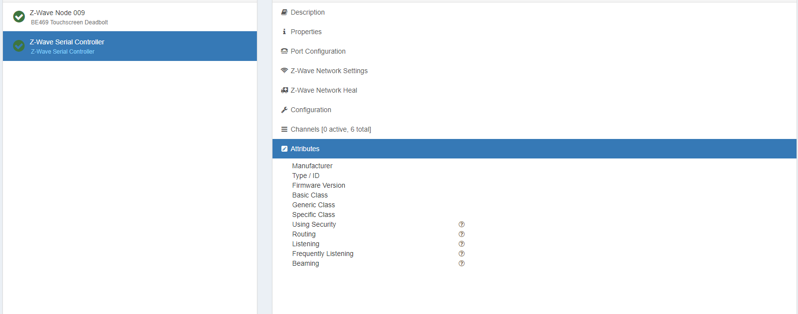

NOOB here looking for some help. I have tried everything I have found in the 2590 post before me to get a Schlage BE469WK setup but for the life of me i keep getting “NODE 9: SECURITY_INC State=FAILED, Reason=GET_SCHEME”
I have done the following
Inclusion = High Power Inclusion
Security inclusion mode = all devices
Network Key = is set
I have reset the Lock and reinstalled openhab
I am using a Z-Stick Gen5
2018-03-15 21:12:26.072 [hingStatusInfoChangedEvent] - 'zwave:serial_zstick:1622c7d4dc8' changed from ONLINE to OFFLINE (BRIDGE_OFFLINE): Controller is offline

Unless you have a reason for this, go with NWI. Shouldn’t affect the lock though.
Unless you have a reason for this, go with Entry Control Devices. This won’t affect the lock either.

OK, then it looks like the lock just hasn’t securely included then. What about this?
Thanks Mark!
Here is the Really long Debug file
Yes I took it off the door an it is setting next to openhab
This log doesn’t include the discovery of the device. Assuming you did another inclusion, does the lock show as Using Security in Habmin, under Attributes?
And just to make sure… what do you get from:
bundle:list | grep -i zwave
Hey I am sorry! I didnt get the whole log. I have updated the doc it is really long. None 17 was the lock
Ran the command here is the output
openhab> bundle:list | grep -i zwave
228 │ Active   │  80 │ 2.3.0.201803111809     │ ZWave Binding
openhab>
update I am seeing this alot.
NODE 17: SECURITY NOT required on COMMAND_CLASS_VERSION
This is a very interesting log (thanks :slight_smile: ). I need to understand it better, but there are some delays following the inclusion that probably are too long, and this is probably screwing up the secure inclusion.
Secure inclusion needs to happen within a number of seconds of the initial inclusion (10 to 15). There is at least a 10 second delay here, so at best we’re border line.
It looks to me like the stick is not responding as I’m expecting to the “end inclusion mode” command, and this is causing the delay. I need to have a look to see if there’s a better way to handle this - I could probably (safely) change this to not wait for the response from the stick, although maybe that causes other issues…
I’ll have a think about this over the next day or so and probably propose a change.
As a matter of interest, what stick do you have? You said “Z-Stick Gen 5”, but I’m not sure what manufacturer that means as there are a lot of Gen 5 sticks out there…
@Clinton_Johnson can you provide another log please - same sort of thing as before. I’d like to see if the same thing happens.
Also, please provide the raw log - something is truncating lines in the log that you provided earlier, so long lines are all uniform length with a $ on the end and I loose a lot of information.
Thanks.
