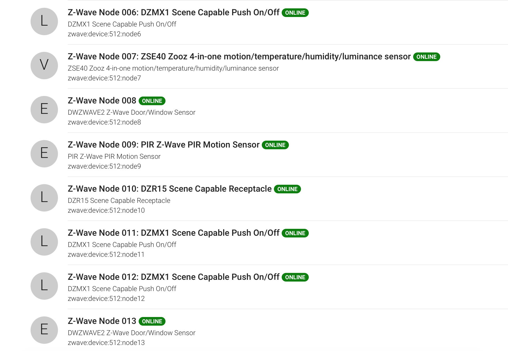

this is what I get with contact sensors -
2018-07-19 21:38:17.156 [WARN ] [wave.discovery.ZWaveDiscoveryService] - NODE 8: Device discovery could not resolve to a thingType! 7FFFFFFF:7FFFFFFF:7FFFFFFF::0.0
2018-07-19 21:38:17.169 [WARN ] [wave.discovery.ZWaveDiscoveryService] - NODE 13: Device discovery could not resolve to a thingType! 7FFFFFFF:7FFFFFFF:7FFFFFFF::0.0
And HAIL is not happening. All devices finished initializing, contact sensors online but unrecognized.

Yes I did wake them up. It took 4-5 hours for all nodes to initialize. DWZWAVE2 Z-Wave Door/Window Sensors (node 8, 13 f.e) are online and working, but don’t have description in paper ui like other nodes. My biggest problem again DZMX1 dimmers. They don’t report status, when manually operated. Is there anything we can do about this ?
