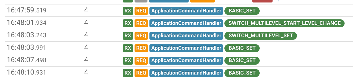

Here you go. I turned the switch on, changed the dim level, turned it off, turned it back on, (might have changed the dim level a 2nd time), and turned it off. I also did the same thing with the Aux switch. Main switch is Node 3, Aux is Node 4.
https://drive.google.com/open?id=0B77VHtwPft8eVjhISzhYeWRwTWM

Regarding the switch 4 - at the end of the log I see some messages from switch 4 - I guess this is where you are switching it to change switch 3 state? There are no switch 3 messages received during this time, so I think what I said earlier is correct.

Binding is updated again… Hopefully it will now work when controlled directly from the switch.

It’s working now!! Thanks.
