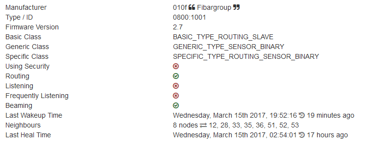

Mmh, that’s strange: After reading this post I checked my devices, and I discovered that currently all my battery devices have the routing flag set - e.g.:
So I have to exclude and reinclude them all?
Yep, same here. Makes me think that information isn’t really accurate…

I’m not sure why routing would show true - normally, if a device is not listening, then it also can’t route, but the listening flag is correct. Normally I think both are set the same - if it’s listening, then it’s routing, and if it’s not listening, then it also doesn’t get involved with routing.
You could take a look in the XML to see if that shows the same - it should, but maybe there’s a bug in the binding. I checked the code and everything looks ok, but you never know.
According to my XML files all devices are routing but device 1 (which is the controller, right?). For example my Sensative Strip really doesn’t talk when it’s not at gunpoint, but here it says it’s routing.
I’ve had a bit more of a read, and I think this is ok. The binding doesn’t use this flag at all - it’s the listening flag that is used to detect battery devices in the binding, and probably the controller.
The routing flag seems to indicate that the device can route - not necessarily that it’s a router (ie that it can act as an intermediary). It’s perfectly ok for a battery device to use routing, so this is fine.
